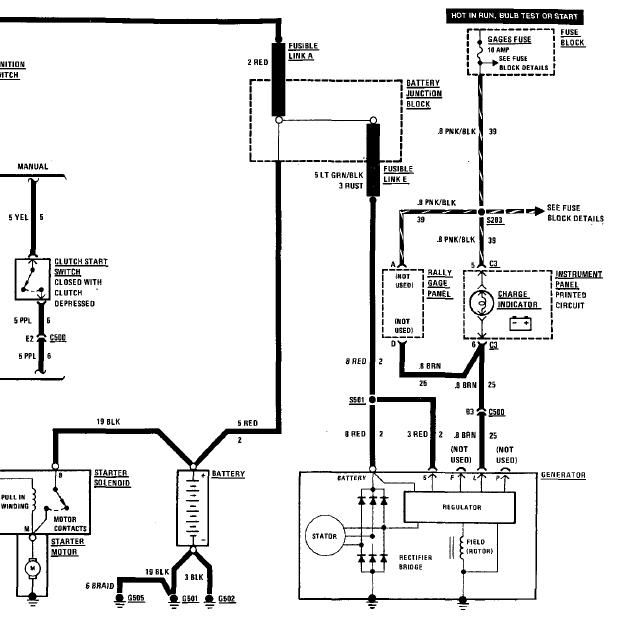

i have a 86se with a 4 spd im in the middle of putting a 3.4tdc in it cuz it didnt have a motor when i got it , i was wondering what the 2 extra wires comming off the alt cable are, theres one at each end and the other wires that are on the starter wire

Maybe this will help you figure it out.

its got one of the wires im trying to figure out but theres still another one that comes off the side that goes to the junction box for the battery that has a one wire plug on it then the ones on the starter i dont knnow either
