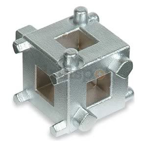

Turn the piston back in with this:

Where did you buy your cube??

Report this Post11-08-2008 11:06 PM Click Here to See the Profile for HudiniSend a Private Message to HudiniDirect Link to This Post
My local Advance Auto has it in the tool section. Part Number: 648410
What a great little gadget for less than ten bucks!

Keep in mind to use that tool on the 88 you will probably have to dissemble the two caliper halves. The outer half of an 88 caliper gets directly in the way of using a socket wrench with that adapter.
Now if this thing could be made in to a Rubik's Cube type puzzle the next million dollar thingy would be invented.
