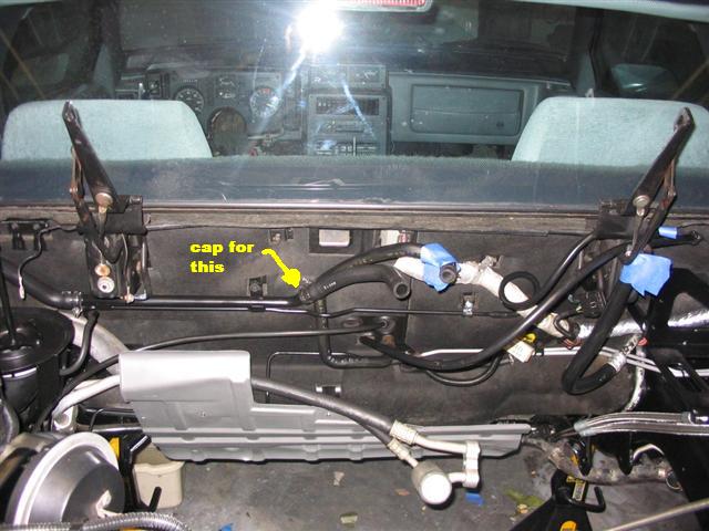

That pipe you have superscedes the large tube on the firewall, so the one on the firewall needs to be capped off.
As for the connection of the smaller tube to the air filter, there should be a nipple at the base. Literally underneath where the filter sits.
Let me see if I have a pic.

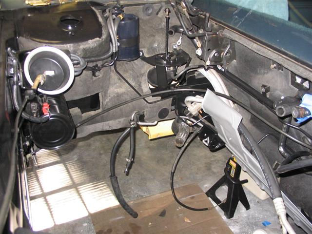

sjmaye
Posts: 2468
From: Hendersonville, TN USA
Report this Post11-03-2008 07:01 AM Click Here to See the Profile for sjmayeSend a Private Message to sjmayeDirect Link to This Post
sjmaye
2468 posts
Member since Jun 2003
Try these.
