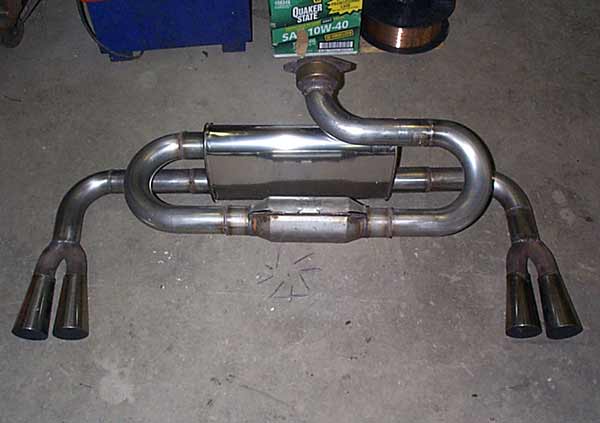

This one is only possible without a trunk

Bridgetown if i did an exhaust like yours but came over the top with a tight 180 and had no cat with another 90 to the flange i wouldnt think id have to cut the trunk if the bends will work like that?

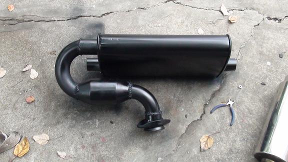

Here is mine: Fairly simple/cheap to make. 2 2.25 mandrel bent U bends, a high flow cat from ebay, and a camaro stock replacement muffler

i saw yours before in another thread and thats what i was going to try and do minus the cat. How did you get your flange?

I got the flange from an original exhaust. It is the piece that was originally on the motor, I have heard that autozone carries a similar one, but I have never seen it. I would try junkyard / a user on the forum.

I have also only seen the 3 bolt style flange at autozone but im going to try and find one off a stock exhaust so i can use part of the down pipe to. J/w though did you have to cut/dent the trunk?

My trunk is cut out flat. The way I mounted my swap, I just about had to do it. The turn coming out of the manifold would have been so sharp, it would have been really choking the exhaust. I don't see why you shouldn't cut the trunk. It is a simple mod, and just lay down some metal to cover the hole + carpet and it looks good. You should really consider cutting it out, it makes fabbing an exhaust a ton easier, as you can actually see what you are looking at.
