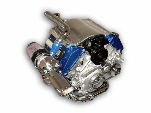

At one time Mechtech and CHARFAB both made aftermarket PCM's for the Short Star. Mechtech also had a 425 HP turbo version. I seem to remember that They used to advertise 600 HP? But that may be the difference between the single turbo and twin turbo setup? A quick search show Mechtech still lists the ShortStar on the website.
Mine is stock and wont put down numbers like that but I do love the way it sounds and feels.
GM severely detuned this engine in the Oldsmobile and "if" the after market were there for it I am sure this engine would be VERY widely used for engine swaps.
The ShortStar, 350 TPI L98 and stock 2.8 V6 side by side. The S* is big. It is just as wide as it is long. The 5 speed getrag will bolt up to it. I have done it, but never tried to run it without the stock 4T65E that it came with.
