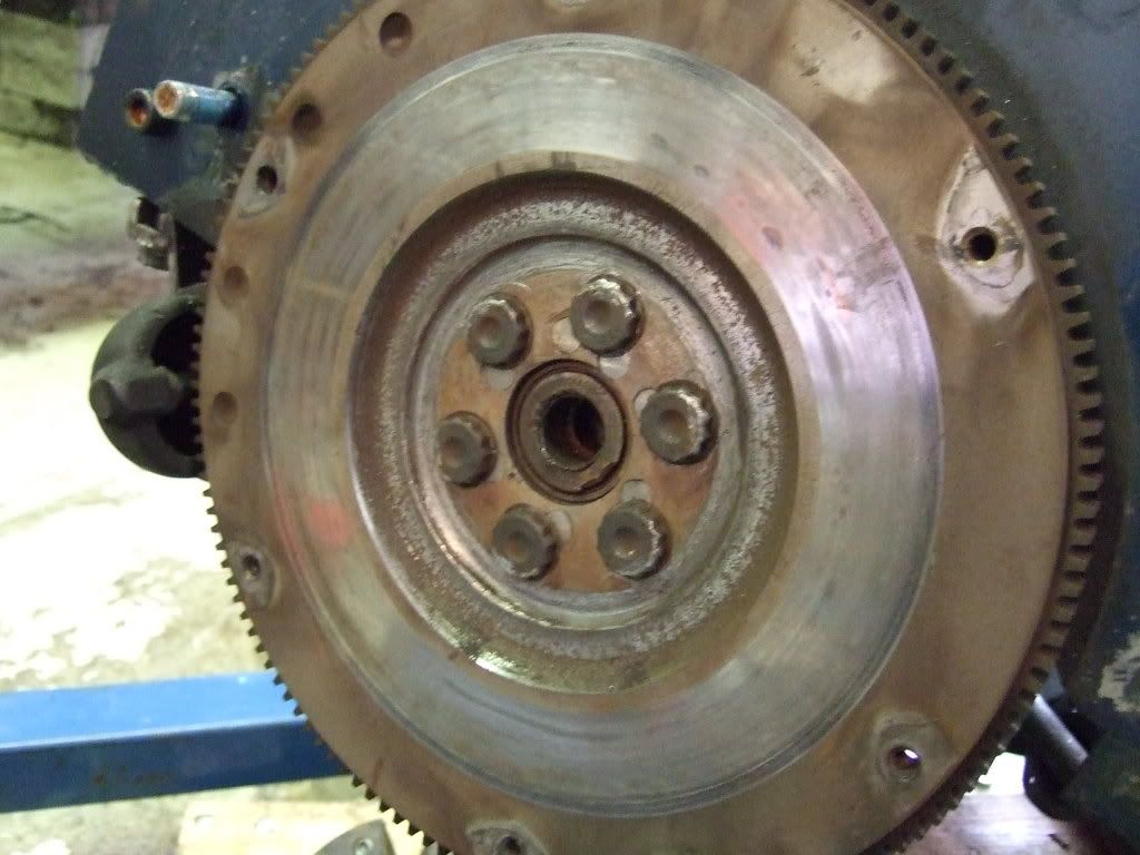

So my day has come where my Spec clutch has failed me. I have 1100 miles on the clutch. I have not taken it apart yet to see what actually failed. The clutch failed under normal driving conditions. It started with a scrapping noise the progressed to locking up (basically direct drive).
has anybody had any luck with specs customer service, and getting these warrantied?
Its a spec stage 3, and my engine makes about 260hp and prob. like 320 torque.
One of the springs popped out and is gone, idk where it went, there was half a coil of the spring sitting in the clutch.
Its hard to tell form the pictures but the disc is "con-caved or con-vexed" which ever term you prefer to use. in other words it no longer flat. What the heck did this? HEAT, SPRINGS? idk... Do you?
PICS BELOW.

It sounds like you broke a spring in the hub that popped out and jammed in the pressure plate. Get that spring out of there and I bet it'd be fine.

Anyways he explained it to me that with high torque engines causes the input shaft to "flexing" or "move out of axis" as he described. Since the transmission dose not use a pilot bearing this increased the flexing and over time this will cause fatigue on the springed hub. he said anything with a decent amount power needs to have solid hub disc.
And since im out of my 4 month warranty i can not claim it under warranty. And i'm not the guy to make a big deal out of a something dumb. By the time shipping costs, there, back and the turn around time its not worth it to me. I just will simply not buy another SPEC product.

Vibration causes the sprung hubs to explode. Either from being misaligned or from bad input shaft bearings, which is not the throwout bearing. (my problem on my transmission) A solid hub will deal with the vibration better but will not correct worn bearings.
Good thing to do, since you need a clutch anyways, is to have your input shaft run-out measured at a transmission shop. More than likely they will do it for close to free if its out of the car. Also, input shaft play (run-out measurement) cannot be 'tested' by jiggling it by hand, it must be measured as i found out.

When a performance clutch is installed (as stated by Spec), the runout in the Getrag input shaft bearing is critical to longevity. Since the Fiero clutch disc just hangs there supported on only one end (no pilot bearing) Installing these clutches in Getrags that have been reconditioned seems the only way to get them to last. This probably explains why some praise the Spec 3 clutch while others curse them. Word to the wise, before installing a clutch get out the dial indicator and measure the runout.

Spring hubs suck. Don't use them. I will never use one again. I have broken springs on three manufacturers. I use a stage 4 solid hub now and feels just like the rest but without springs to worry about. Have about 3K miles now. Will tell you more when I get it to 10k.

ive used them in two cars now both of which get or got abused relentlessly. both in the svo forums and the fiero forums people complain about the same things. i think that while clutches seem relativly simple, high performance ones may be a tad tricky.
what youre talking about with the groaning noise is the clutch scraping on the friction surface from letting the clutch out too slow or with just the wrong amount of gas. this happens to me all the time. the clutch is locked up now probably because the throw out bearing is stuck on the input shaft and this is generally due to riding the clutch too much which is difficult not to do on a stage 3 ill give you that. but customers do this kind of stuff all the time to stock clutches. if you look at the clutch disc youll probably find some of the friction pads are different heights now due to uneven pressureplate clamping. caused by riding the clutch to much, i live in dc area and its the primary failure in lots of cars. that and 16year olds.
as for blowing springs out of clutch discs(assuming its built right no mechanical defects) thats from shifting too harsly causing the springs to bind and pop. when they say it can handle X torque thats based off of the spring strength used in the hub. it means that the clutch springs can constantly resist binding while rolling down the road. this type of force is different than suddenly smashing into the springs which will cause them to pop and is the very reason unsprung clutches exist. if you properlly slip the clutch at the strip or can get the engine/trans reasonably rev matched before shifting on the track then this kind of excessive force can be avoided. it becomes nessesary for unsprung clutches in high powered cars like a muscle car because the engines are so big and have so much torque theres nothing else to do.

Pictures added in first post...... check it out. And can you tell if the clutch is the "installed backwards at spec" disc?
thanks
thanks
That clutch is fine. Failed just like my previous one. Just get rid of the springs on whatever you buy. No matter what brand clutches will fail. Before was Centerforce when many Fieros were using it. Today is Spec. Tomorrow may be Clutchnet or whatever bandwagon we get on. People will post failures. But the probably biggest qty of people with good ones will not come here to post "hey look at my clutch how nice is still working!". And that applies to all brands. Then bigger engines with lots of torque will be harder on parts. No pain, no gain
