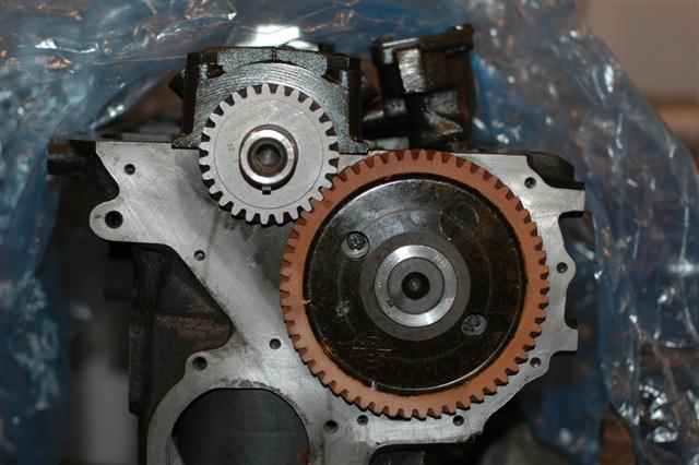

I made one small error in my previous post. I said to drill/tap one hole in the center of the cam gear, I meant the center of the camshaft. This is to pull the new gear on. I have a question though, is the entire cam gear made of phenolic fiber or is it like sbc cam gears where the center section is steel and just the teeth are "plastic"? It's been 20 years since I had a duke opened up and I couldn't even remember it was a phenolic gear so I'm not sure but I suspect the teeth are phenolic and not the entire gear.

The gear is a metal center with a "plastic" gear.
Here's a pic, it's upside down on an engine stand.
