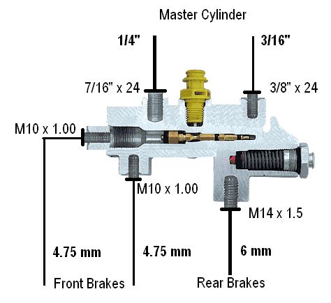

The rear fitting on my '88 at the combination valve is 14mm X 1.5mm.
I'm not certain but I believe the rear line is 6mm.

confirmed, both the prop. valve end and junction end is M14x1.5. the fittings going out of the junction to each wheel are M10x1.00

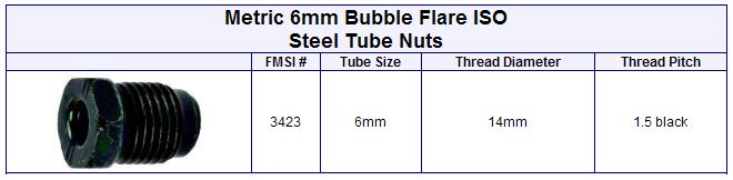

found the fittings on ebay...
http://cgi.ebay.com/ebaymot...6QQitemZ370072917147
the stock line is actually 6mm and not 1/4" but you can just drill the center of the fitting out a bit to fit the 1/4" line you already have.

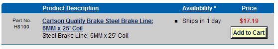

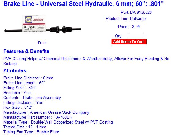

The ones on ebay look right but may be standard metric tube nuts (invert flare). The Fiero tube nuts are bubble flare:
6 mm brake line is sold by NAPA and others. 3/16” line is considered to be the same as 4.75 mm.

NAPA here has neither 6 mm line OR ANY METRIC fittings !

edit: The line nuts on the above (12 - 1) are the wrong size for the Fiero (14 - 1.5).
Parts America has the same lines and also some made by Carlson. Bulk hose too.
Fiero was again ahead of it’s time. GM is using European (DIN/ISO) brake lines on new cars and trucks.

Is this combo valve diagram (88) accurate? Corrections please.
Primaris
Posts: 550
From: Oak Grove, KY USA
Report this Post11-03-2008 02:20 AM Click Here to See the Profile for PrimarisClick Here to visit Primaris's HomePageSend a Private Message to PrimarisDirect Link to This Post
On my '88 these are the measurements. The changes are in red:
edit:
BTW where did you find such a good picture of the combo valve?
[This message has been edited by Primaris (edited 11-03-2008).]

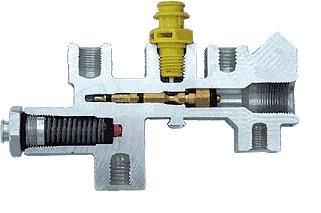

Originally posted by Primaris:
edit:
The picture started life like this:
Found at: http://aplsweb.com/Topics/Brakes.htm
I just chopped it up and moved things around in Paint.
edit: Thanks for the corrections!
