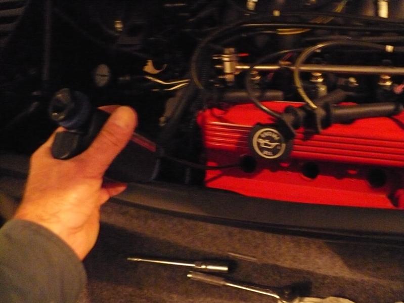

The engine shop loaned me their borehole scope to look at the top of the pistons. If the engine was burning oil past the rings, the outer circumference of the piston top would be shiny where the oil was washing the piston. I took some pictures by holding the camera on the scope eyepiece and the pics are not quite what your eye sees, but get idea of what's there. I only did the rear bank as the front bank would need a longer scope.
The borehole scope:

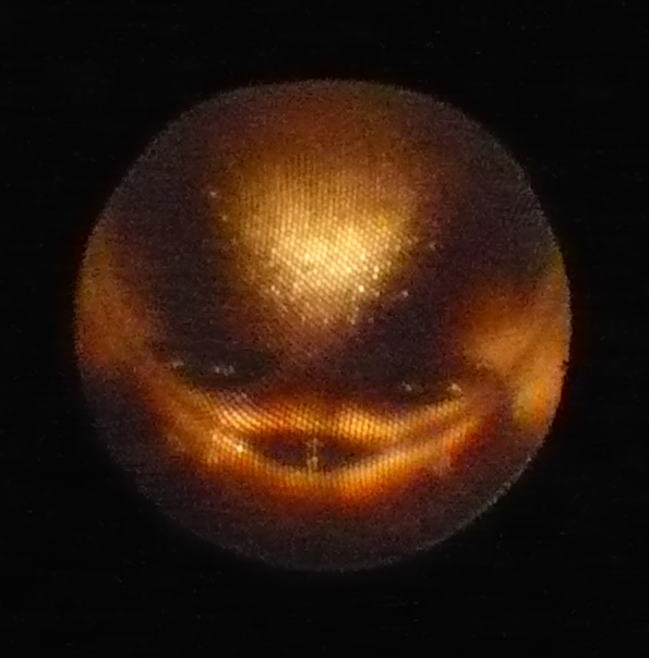

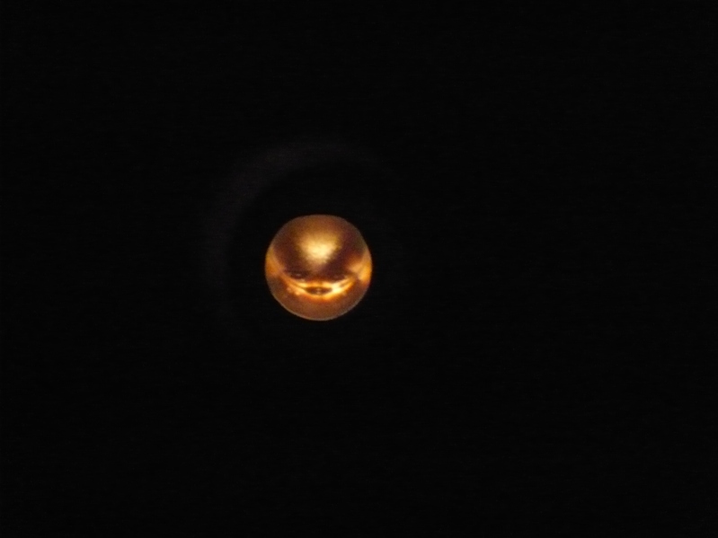

A typical piston top in my engine:
A zoomed in view of another cylinder:
The shiny bits in the center are reflection from the scope light. The edge of the piston was shiny for about 1/8" and the eyebrows for the valves were also shiny on the edge. So this seems to confirm my rings are blowing by.
These pics were taken before the "Commet Treatment".
