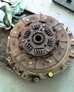

Well got the clutch and everything replaced and the cradle put back in the car today. Just need to finish hooking up all the cables and hoses tomorrow and hopefully be back in business.
This is what the clutch looked like when we got it out.

Yep, that doesn't look good!
