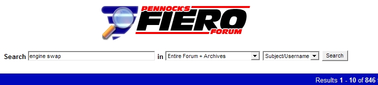

The first thing to do is Plan evrything and make an estimate of your costs. You might need custom engine mounts, etc. depending on which swap you do. Here's a good place to start for all the info you need and more - EIGHT HUNDRED forty-six threads on engine swaps (before you start another one)
