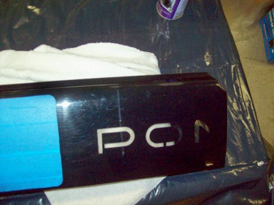

there some light swirl marks on my fastback tail lights, what should i use to buff those out? I want it to look like glass. I want to make them smooth, then mask off the clear part of the lens, and use some niteshade spray to darken up the black parts, like GoKart did .
