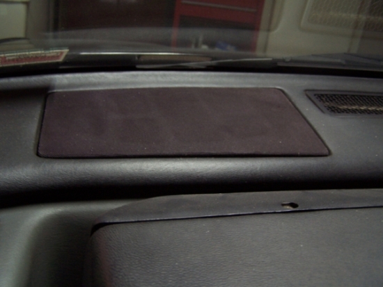

I just used Wal-Mart flat black on mine. Looks good I think. And no fire needed.

Originally posted by sparx22:
Did you spray the fabric Joe?
Yes,frames and faberic . All at the same time.I just set it on my 16 ft trailer edge and painted them both. 30 min later I put them back in the dash.

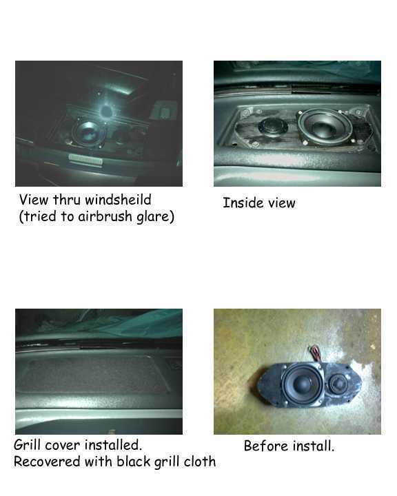

I used speaker grill cloth and replaced mine.
Just cut off the old and glue on the new. I changed mine 10-12 years ago and they have not faded.
I also like how you cannot see the oval cut-out and the braces of the plastic frame under it. It gives them a smooth look.
I bought the cloth from here:
http://www.speakerworks.com...loth_fabric_s/25.htm
They have a variety of colors as well as near stock colors.

I got new black speaker cloth from JoAnn's Fabrics. (They also sell headliner material.) I ripped off the old fabric, washed the plastic frame/grill with simple green, and then attached the new speaker cloth with fabric adhesive.
