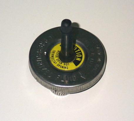

i havent been able to easily bleed all of the air out of my clutch system, nothings leaking its just hard. ive tried everything and mabye every tool out there to do it to no avail. then i got fed up and made a tool, heres what doesnt work
gravity bleeding, tandem(one guy pumps, one guy cracks the valve) or any variety of tandem bleeding), and suction bleeding. ive also tried bleeding it most of the way and cracking the bleeder every day to get the airbubbles slowly, doesnt work.
what does work is take an old master cylinder resivoir cap, drill a hole in it and the rubber seal and then GENTLY blow air into the hole with an airblower, this forces the air out of the bleeder into a bottle or the ground without reintroducing any air into the system(unless you run out of fluid, so dont). i pumped a hole bottle of dot5 though my system to clean it out of the last 20 years of bad bleeding and dot3 and as soon as i shut the bleed screw the pedal was firm and solid. i can also feel when the pressure plate pops out(spec stg 3, should be very noticable) which i couldnt do before because air would just stay in the system.
hope this helps,

Did you set your air pressure at a certain level? I don't think I want to use 90 psi of shop air.

im not going to claim i invented the method of pressure bleeding. i had to do a slave cylinder on a saab 9000, the gay one(well, they all are) with the clutch in the front of the motor and the trans is the oil pan. apparenlty thats the only way to bleed the clutch.
i found at least on my car that any form of suction bleeding woudlnt work, i suspect small holes somewehre but i cant find the damn things, i rebuild the master and slave cyl, and the slave cyl is heat shielded with a reflective wrap, the exhasut is wraped, and theres a metal panel seperating the two. the line isnt leaking cause i cant find a leak.
it does work the best though, for me, though my car also doesnt like to have the cooling system burped like other people can do. when my car burps it can and will shoot coolant over 12ft in the air so i must vac the system down with my snapon radkitplus
