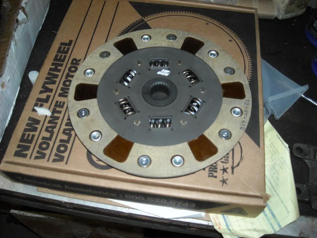

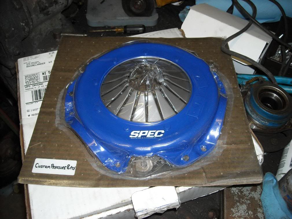

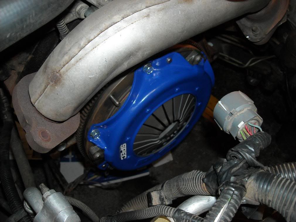

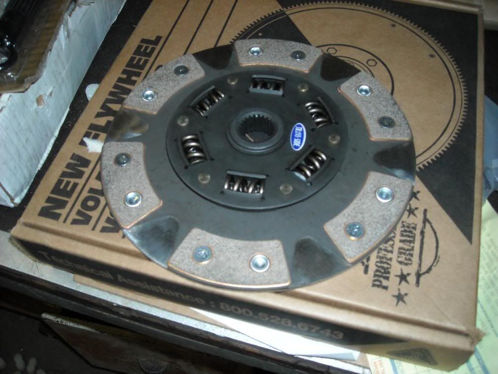

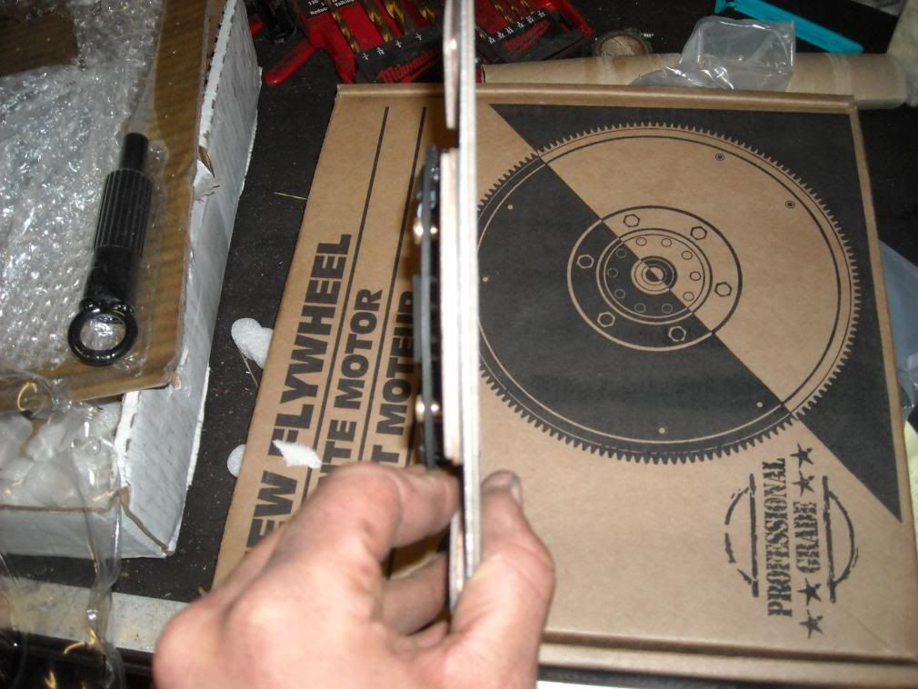

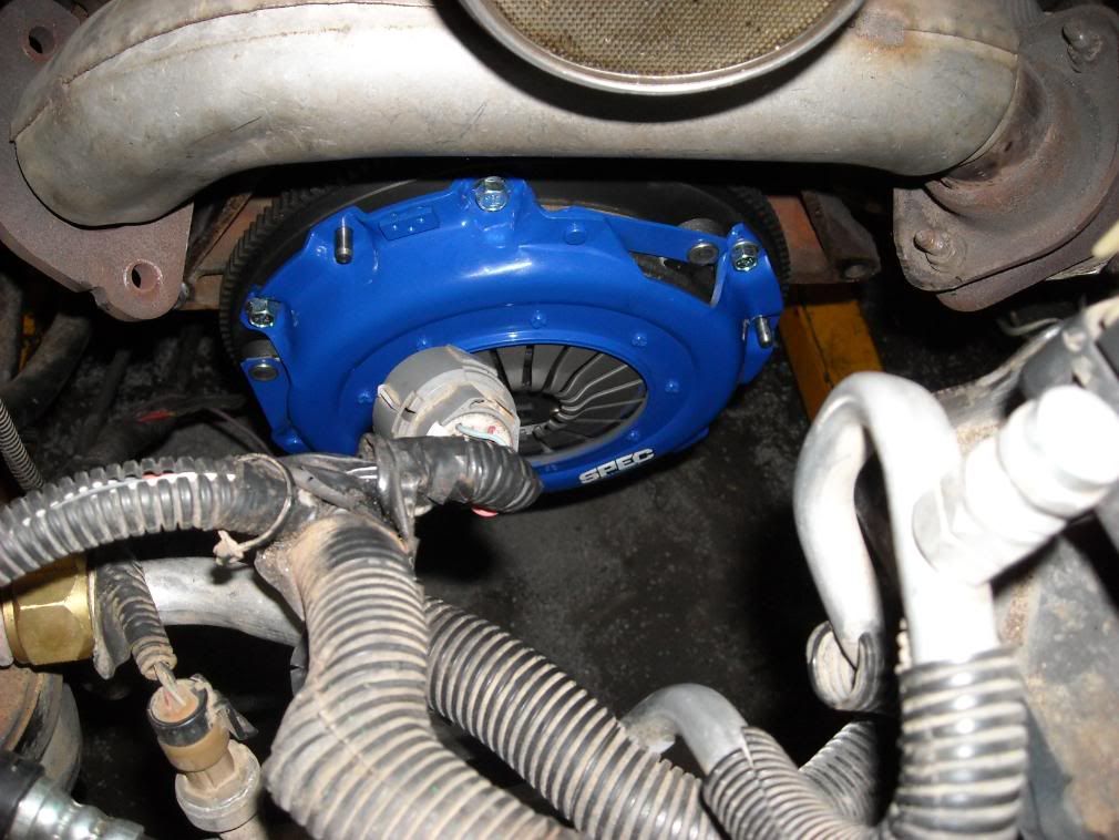

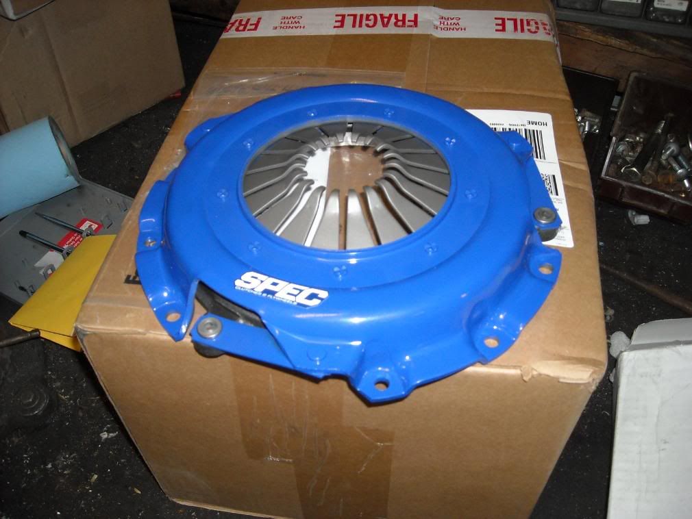

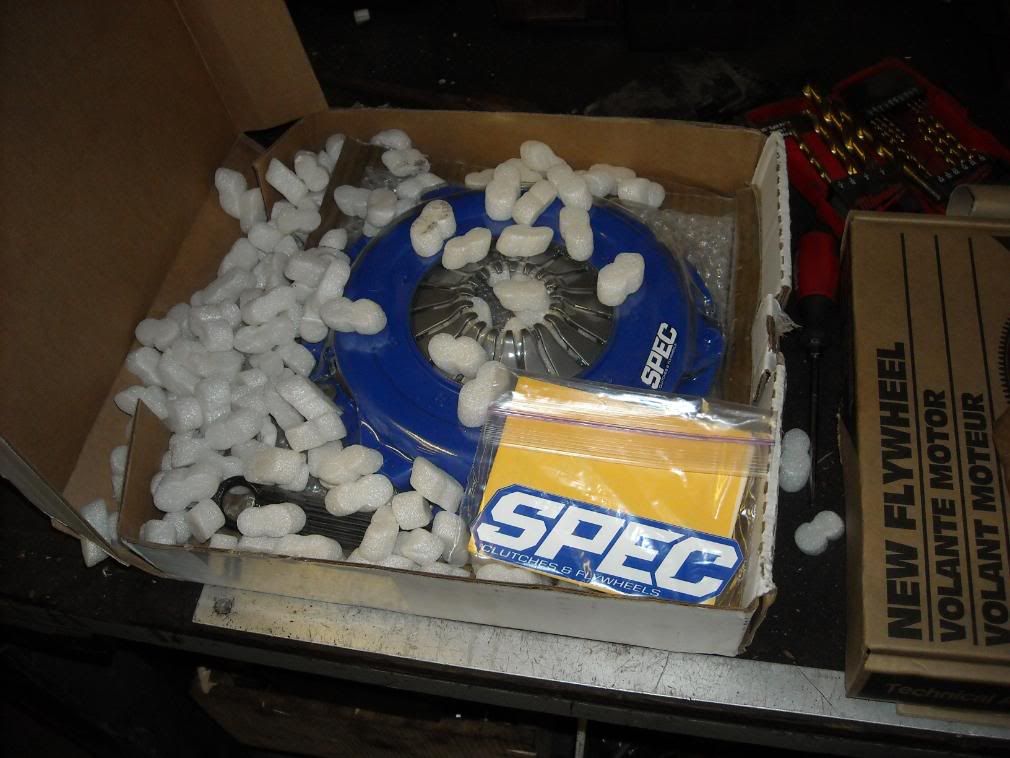

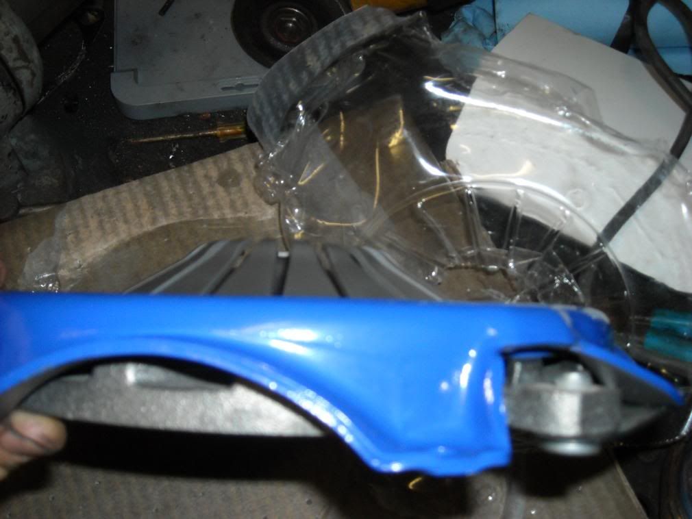

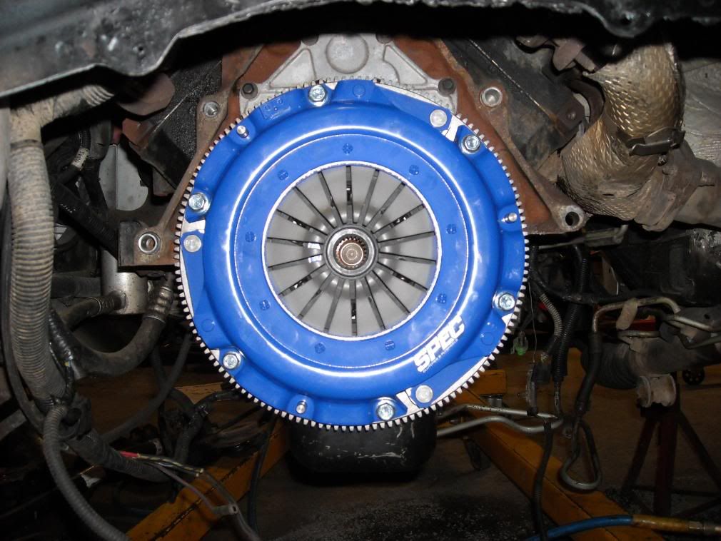

The thickness of the Camaro Flywheel is 1.24". I finally have the time to post pictures, so here they are.
Here are the pictures of the first setup I ordered. I took a measurement wrong, the pressure plate was just a tad to thin.
I re-ordered a pressure plate, and this is what it looks like.
I have no complaints other than that is loud. It chatters really nicely, as some of you may have seen in another thread. But for what I paid, I am really happy. And yes, you should be able to use the 3400 Camaro Flywheel with this clutch. I'm not positive, but it is worth looking into.

His pressure plate is a custom piece which I'm assuming properly places it relative to the transmission and throwout bearing but that will not correct the apparent spline contact area deficiency. Perhaps one or two spacers found on the auto flywheels can help bring it into a safer range by moving the flywheel further into the bellhousing if there is enough room to allow the flywheel centering flange on the crank to continue to work.

No it does not. I didn't think to take any measurements of the clutch, but I'm sure that I can get them from SPEC if you guys want them.

Again, I wish I had the measurements, but David Norton and I checked the spline contact, and it was fine. We have 1.47" from the face of the bellhousing to the start of the input splines, and the from the enging block to the flywheel face is 1.34". You can see what a nice offset there is on the clutch hub, so I don't think there will be a problem.

In the pics, it looks like Spec installed the center splined hub backwards so it protrudes from the tranny side of the clutch disk (vs. the flywheel side like their normal fiero application clutches... when installed correctly). This will shift the spline area of the clutch disk closer to the tranny and help ensure proper engagement of the splines.

That clutch center spline hub is installed the right way for all the getrag/F40 I have used. It is not backwards. It will face the trany side. Otherwise it will hit the flywheel. Cannot be installed wrong (unless you force it). From your measurements it looks like you have 0.13" distance from flywheel face to the face of the input spline shaft. That's about 1/8". Usually the clutch friction material on that side will cover that distance so the whole hub will fall over the shaft nicely.
I think the key item here is the PP. It has to go back towards the trany enough for the hydraulic bearing to release it properly. You can see that on the 2nd unit the fingers are more straight to make it taller (if put flat on the floor) compared to the other and thus closer to the trany.
