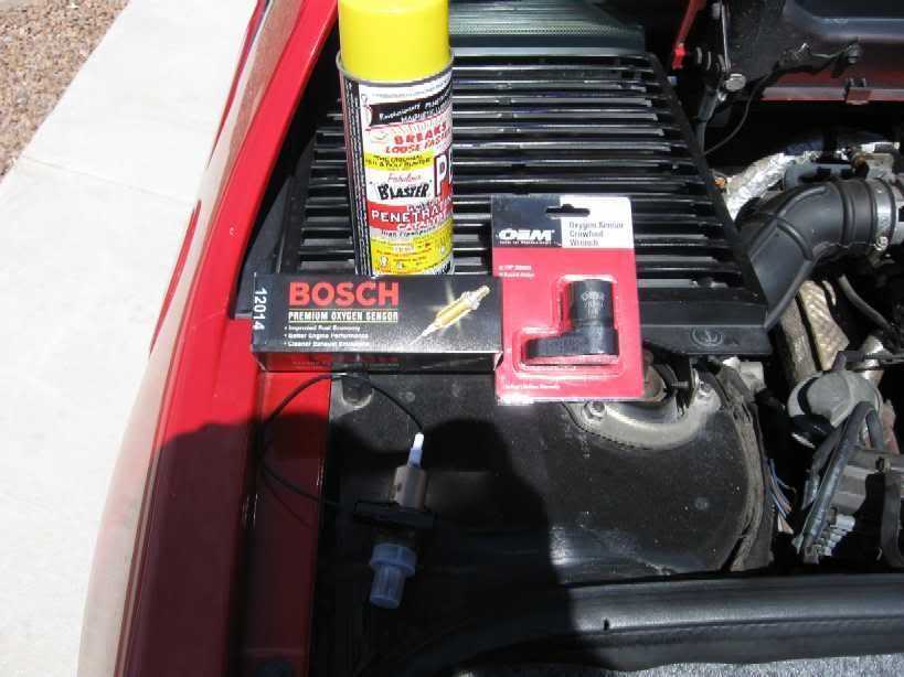

Ok, I could not get the other used O2 sensors out of the y Pipe's so I broke down and bought a new O2 sensor. I could not find an AC Delco off the shelf so I got the Bosch. Also picked up the "tool". I have the old one "soaking: rigt now. I will give it a go when it cools off out side this evening.

Just got back from a few log runs. Installed new O2 sensor. My "lag" is much better and no O2 lean code. Still have a slight idle hunt. I pulled the IAC and it was filthy. I cleaned it off and reinstalled. Getting better with each little tweak. Next I will pull the TB and clean it up. If that don't work, I will try the Idle adjustment procedure and see what that gets me.

Ok folks,
Here's what I did today:
Pulled the TB and gave it a thorough cleaning. Th IAC ports were filthy and the tube that runs from the TB to the manifold was almost plugged with crude. Also the TB butterfly was pretty nasty especially on the intake side. Pulled the IAC out of the TB and gave it a real good going over. Reinstalled everything, Performed the adjustment of the IAC, disconnected the battery, etc. After I got it all back together and the ECM reset, I went for a drive.
I can not believe the difference. Wow..... Rock solid idle @ 900 RPM, No surge what so ever. All the lag between idle and 2500 - Gone. Car runs and pulls hard all the way to 5k - thats where I let off......
After I ran some logs yesterday, I sent them to Dodgerunner and he suspected that my IAC was dirty and not reacting quick enough thus my issue with the car dying when I decelerated to a stop. That issue is cured too.
Sometimes it is the simplest, easiest things that make the biggest difference. The only sensor I replace was the O2 and it made a difference too. Here's what my weekend fix its cost.
Bosch O2 Sensor from Autozone - 19.99
Can of carb cleaner - 4.00
Can of PB blaster - 7.00
O2 sensor tool - priceless - 9.00
So for 40 bucks, I got a lot taken care of.
Thanks to everyone that had a suggestion. Big thanks to Dodgerunner.
Pat

Originally posted by katatak:
Ok folks,
Pat
