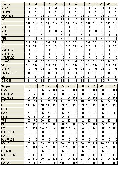

serealport
Posts: 286
From: Memphis TN USA
Registered: Apr 2007
Report this Post10-19-2008 02:14 PM Click Here to See the Profile for serealportSend a Private Message to serealportDirect Link to This Post
what numbers would winaldl give for a good O2 sensor
i ran winaldl but dont undersand the numbers
one was idle the other was around 2k
I'm a newb at WinALDL, but I can tell you weren't going very fast.

Report this Post10-19-2008 07:11 PM Click Here to See the Profile for serealportSend a Private Message to serealportDirect Link to This Post
"I'm a newb at WinALDL, but I can tell you weren't going very fast"
and no i was in park dont know how fas i was reving because tach is not right top is idle
what tells what??

Hudini
Posts: 9030
From: Tennessee
Registered: Feb 2006
Total ratings: 165
Report this Post10-19-2008 07:34 PM Click Here to See the Profile for HudiniSend a Private Message to HudiniDirect Link to This Post
The numbers at the top are time (Sample row). Does not matter how much time, just that everything below that number in each column is for that time period. It's a 160 baud ECM so the actual time is quite slow compared to the 7730 at 8192 baud.
Now go down the left most column to find O2. Now read across. The numbers going high then low tell you the O2 is switching between rich and lean. This is what a narrow band O2 does when it's working correctly. If it stays high then the car is rich, low numbers are lean.
Realize the actual O2 may be switching far faster than WINaldl shows simply because of the slow update time for the ECM at 160 baud.
serealport
Posts: 286
Report this Post10-20-2008 07:39 PM Click Here to See the Profile for serealportSend a Private Message to serealportDirect Link to This Post
is this reading good for the o2
because the car is running really rich
but i just found a busted spark plug wire and replacced it so now that i have the car running on all cylinder i am trying to run the diagnostics again but every time i plug in the aldl cable the car idles rough and sometimes dies

WKDFIRO
Posts: 1637
From: Cerritos, California, USA
Report this Post10-20-2008 10:23 PM Click Here to See the Profile for WKDFIROSend a Private Message to WKDFIRODirect Link to This Post
Years and years (and years) ago, I was stuck with a light just before a smog test on my 87 coupe and grabbed a Borg/Warner (Pep Boys) to get through testing instead of the AC Delco I wanted to go with. Passed the smog and didn't think much of it until my Check Engine went off. I figured that perhaps I hadn't clipped the connectors tight enough. Turned out that the sensor itself had melted. MELTED! Connection was fine but the rest of the sensor had this sad little droop to it that told me never to get an O2 sensor from Borg Warner again!
Have you checked the usual suspects that would give you a rich mixture? Bad prom chip (it might be in limp mode) uhhhh....I'm having a senility moment, someone else will have the "Aha!" moment for you....
