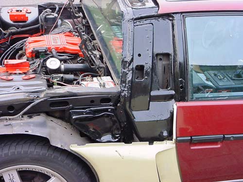

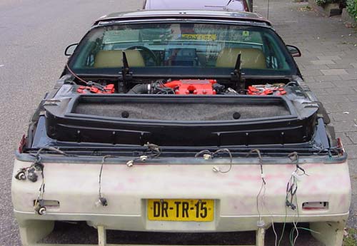

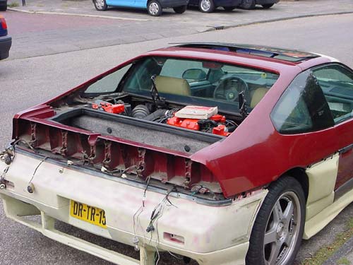

This afternoon I finally swapped the rearclip. It is a daily driver so I had to plan some things but I finally went for it!
removing lights/vents/trim/ and some bolts. After a few hours the clip was ready to go!
What is missing in this picture? It looked so strange I decided to clean and paint immediately!

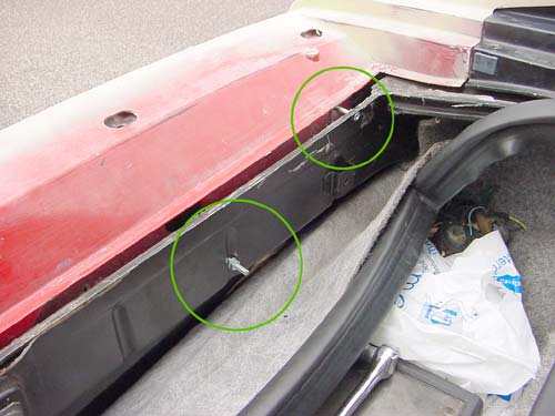

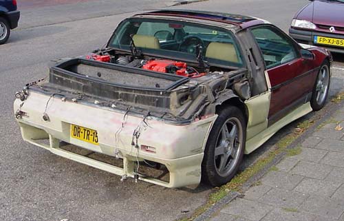

It seems it has been in an accident sometime....the fuelthingie (what was it for?) is quite dented and the B-pillar has some spots of repair... this pic was after painting.
Painting was done within 15 minutes. All day it was almost raining and now it IS! Putting on the new clip wasn't too hard and I put in the lights for the picture (will wire them in tomorrow)..here it is:
I am quite satisfied! It is the first time all parts are coming together and it really looks a bit like a big brother of the new Smart roadster(which I have seen for real some times now)!

That tank that is crush is an expansion tank for the fuel tank.

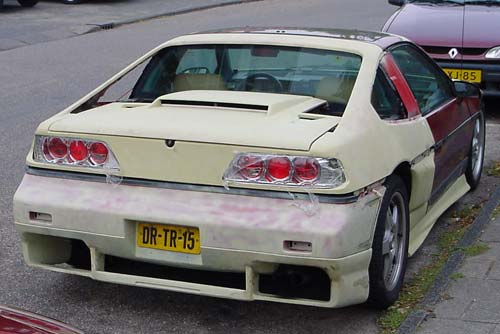

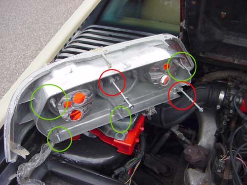

today I mounted the inserts/vents and lights and re-aligned some panels, put back the fuelcap and mechanism... The lights are working great now!
This how I mounted them to the Fiero:
I had been long thinking how the H*** I could mount them to the Fiero. Then I found out I could remove those plastic screw thingies on the back (green) and screw back longer pieces (red)
Made 4 holes in the trunk to mount them (still have to cut a little piece. The trunk carpet will cover them so you wont see anything!
This picture doesn't seem much different from yesterday but more things are in place now. I still like the lights. I wanna see them this evening

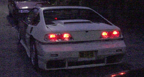

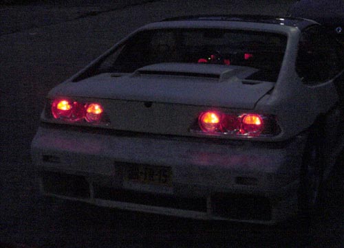

Just took some pics with the driving lights on at night:
The chrome now really works great as the reflexes are changing when you're changing position...nice 3D effect!, for those drivers when I am passing them

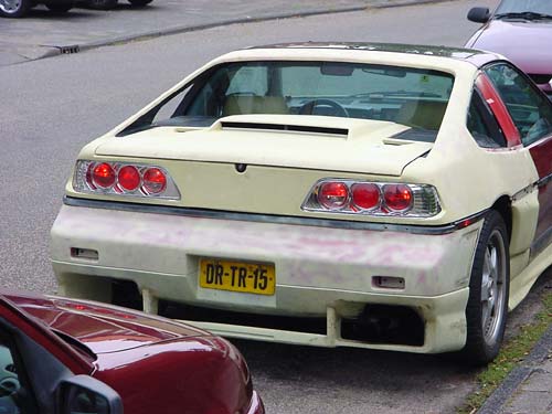

There isn't much changed last weeks on the car itself. Got the exhaust tips in there finally. The old exhaust was quite crappy so when I put the new tips and bends on it still wasn't right. now it is!
I took a mold from the taillight piece because it started cracking; there was still some wood in there (covered with layers of fiberglass) but still it appeared moisture could get inside somehow.....(I am still learning) So I am working on the mold. Good news is I might make more products
The nosepiece is 99% finished. I am just correcting some small details so I can take a mold of it hopefully next weekend!
It is quite a bit shorter than the stock nosepiece, I think that will look better on the car. I will take some pictures this week and post the progress......

Thanks! Well most of the work now is making molds and good products. If I can get everything right and good quality pieces I might sell parts! Anyway I keep that in mind so I have more reason to put more time into good molds! Here's the mold from the rear (still working on it) and the nosepiece being covered for a mold.
I have something new though. As it is difficult to get good replacement quarterpanels I decided to try something myself in glassfiber. Took molds from the old quarterwindows (which were already cracked a bit). I decided to do something like this:
I will trim it so it is flush with the sailpanel inserts.
But deadlines are skipped till further notice!
