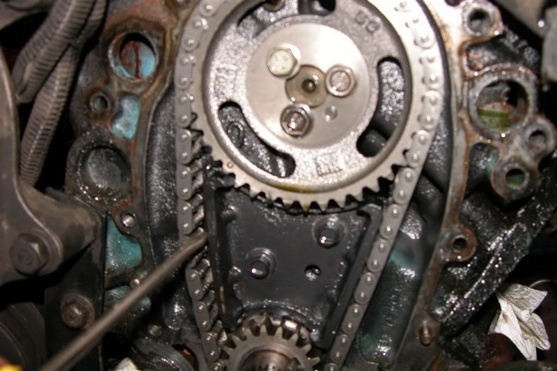

Here is what the timing chain looks like on the 2.8 now. I can see some dark rings around the inside of the cover, but it just looks like dried oil in the chain pattern. Is this too much slack?

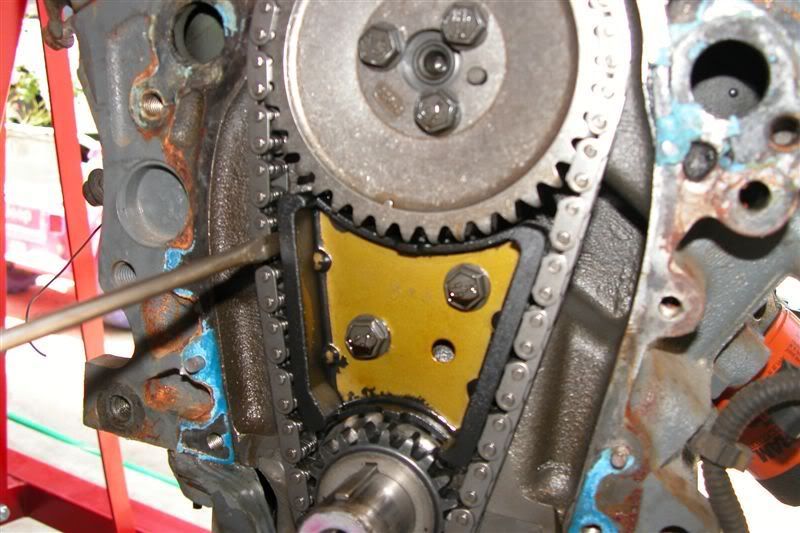

Here is what the timing chain looks like on my new 3.4. Much tighter than the old 2.8
Thanks again. What you mentioned is just what I was looking for. It seemed really strange that it would only knock at certain rpm and only under a light load.

So you guys think that bit of play in the timing chain is OK? I don't want to leave a bad one on there.

Engine out of car. drop the pan then it's Plasti gauge time. Oh, and read your spark plugs. Do they look like you're running lean? Fuel can gum up injectors when you let an engine sit too long. Good luck.
A 3 piece set is $30.00 or so. Change it and scratch it off of your list if "Maybe"'s Flip the engine and gauge all of the bearings but make sure each bearing half and the crankshaft is DRY all of the way around before you use the Plastigauge. Then scratch it off of your list also.
