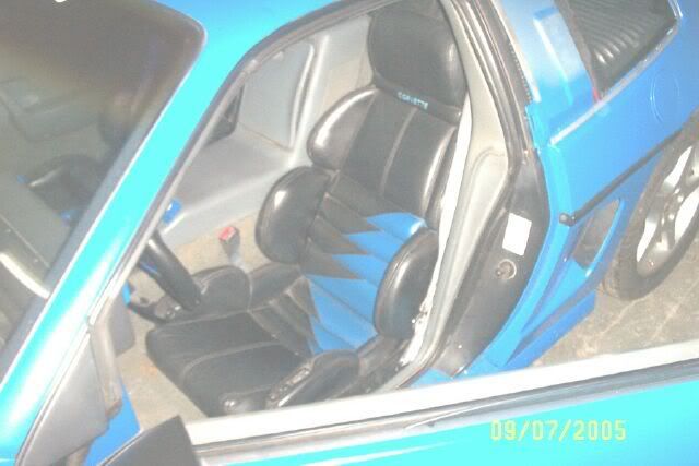

I bought my seats on E-bay. I looked for a long long time just for that style. I can thank fieroguru for showing his seats sometime back on PFF and I downloaded his picture just to keep in mind of that particular style.
My first choice was going to be the 2000 Trans Am seats as my son had a SLP Firehawk that I drove quite a bit and I fell in love with those. BUT after seeing fieroguru's install I changed my mind.

My seats are not electric. What you see is the control for the seat bladders. In front of the seat just below my leg is a switch which electrically moves the side bolsters in and out.
Moving the side in or out is great for some road hugging driving.

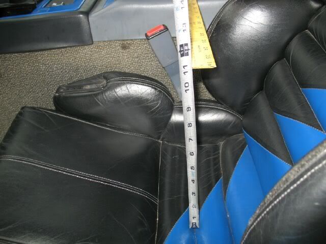

Mine were all electric (see the controls on both sides of the seats), but I got them at a Vette swap meet for a steal and they did not come with the powered tracks (part of the reason they were so cheap and the blue inlays ruined them for the Vette people). My hips/butt is wide enough that I did not need to pump up the bladders to be firmly held in place, so I have never hooked them up either.
