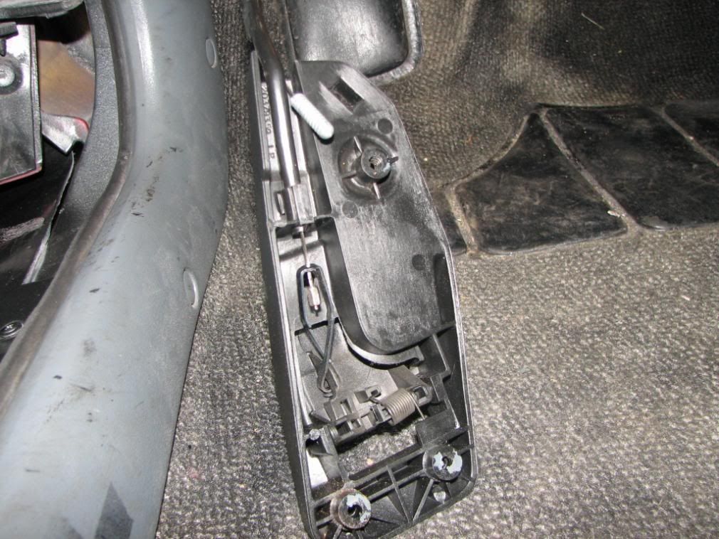

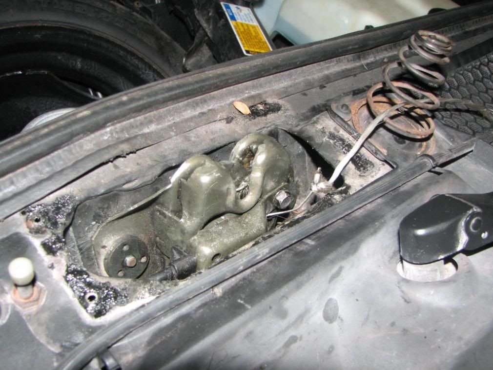

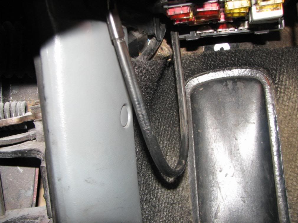

JazzMan
Posts: 18612
Total ratings: 653
Report this Post08-07-2008 01:47 PM Click Here to See the Profile for JazzManSend a Private Message to JazzManDirect Link to This Post
The spare release cable head clips into two ears on the handle assembly after the handle assembly is mounted in the car:
Note how the cable is routed under the main cable.
The hood latch is connected to the cable with a small adapter head that's retained with a 10mm head self-tapping screw:
Hope this helps!
