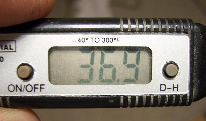

I got to use my AC this morning for the first time on a small trip . I have converted from a non factory AC-ed car to factory AC. After two cans of 134A I am getting 46* out of the vents with 90 degrees outside. . I am undecided about adding the third can of 134A. It is working so good now I am thinking about leaving it alone.
Whats your vent temperature running

I put 2.5 cans in my rebuilt system and get 40* air from the vents. I made sure that I had 40psi on the low side. Starting on the same project in an 88 Formula today. Hoep it works as well as the last....
46* duct temp is ideal for a GM system of that era even on R12. The preasure switch cycles on at 46 psi. On R12 the low side psi is almost the same as the temp at the evaporator core temp. The core temp is higher on R134A. Then there is the efficiency loss transfering from the core temp to the air temp. Mixing 90* ambient air with 40* core temp generally makes about 50* duct temp. You have done great already. Overfilling a system does not make it colder, it makes it warmer.

134a. I cheated- it was only about 90 when I checked the temp, but the car was sitting, so at highway speeds, it might get cooler
This is with a Caddy compressor- I don't know what kind it is, whatever comes on an '88 ElDorado. I had to back off the low pressure switch a little because it cycled too often. THe low side pressure is probably somewhere around 25 PSI at the temp shown above.

Holy Sheep that is good. My wifes 2002 Elantra puts out 38 at about 60 mph. I don't remember the outside temperature, I am in Texas so it was somewhere around 95. Give or take a few.
