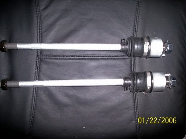

Rear tie rods are solid-mounted. If they are worn the handling will be dangerous.

Let me qualify my post above. Those aren't the worn out originals I took off my car; those are a set of Rodney Dickman's beefed up rods. They are a little thicker where they mount to the Fiero chassis and have a provision for greasing the pivot that the stockers don't have. And I painted them. It even says 'Rodney' on the rubber boot!
