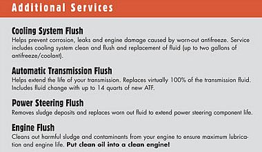

Just got a oil change at a quicky lube place. Was told my engine needed a “flush” cause it was the third oil change. The car (not a Fiero) has less than 10,000 miles on it.
Wonder how many of these “flushes” are sold to naive car owners.
Known to many as the "Wallet Cash Flush"
