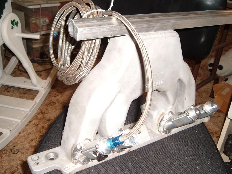

The SD manifold has injector bosses built in, but were meant for mechanical size injectors. I'd be leery about using a 14mm bore injector in the SD manifold bosses, as they wouldn't have much material remaining. So instead I added injector bosses from SDI to the underside of the manifold. It's pretty flat there so it's easy to do.
Not terribly hard, if you want to consider the SD manifold.

Those are some awfully strange looking injectors! What's the reason for the housing, does it eliminate the need for a fuel rail?
A few years ago, I collected all the parts I needed to fuel inject an Olds V8 engine, including a correctly rewired harness and stock 1227727 GM ECM. I did a great deal of research into the operation of the stock system but I never was able to get it to run because of hardware problems and fuel leaks.
I still have all of these parts and I'd like to try something with the Fiero to increase efficiency. This would use stock high-Z electrical solenoid injectors sealed with standard O-rings.
Do you think there's enough material in the stock intake to drill for bungs and weld them on? If not, maybe I should look into the SD intake, but I'd like to do this on a low-dollar budget since I know these projects usually descend into high-dollar money pits
As far as I'm concerned, TBI is only one tiny step ahead of a carburetor, so I'm very interested in figuring out a way to get one injector per cylinder.
