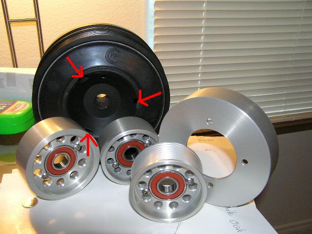

I've removed the crank pulley main bolt on a Series II 3800 SC engine, but need some help getting the pulley/harmonic balancer off. I've seen references to using a GM tool J-38197, but it's VERY expensive.
Anyone who's removed this pulley before, can you shed some light on an easy way to do it? I borrowed a harmonic balancer pulley puller tool, but none of the bolts seem to work on the pulley. Doesn't seem like the pulley has any bolt holes to thread the puller bolts into.

Save yourself alot of money and time and just go here and get the balancer puller. This is the one i used and it worked flawlessly, http://www.zzperformance.co...php?id=339&catid=111 I am going to post a picture of the 3800 balancer with the three red arrows pointing to the holes where the long bolts thread into. The bolts are a very fine thread and very small diameter. Its a metric M6-1.0 is the size of the bolts that thread into the balancer. Dont forget to use a very fine film of anti-seize on the crank snout before you put the balancer back on. This will make its alot easier next time to remove it.

Any good three arm puller will do the job but you need long bolts to reach into the balancer. Dan

Yes, there are holes on the inner half of the pully. The standard HB puller kit doesn't give you long enough bolts to reach those, so you'll have to go to the hardware store and get longer metric bolts to reach. Just take the correct bolt size with you when you go and get 3 bolts one inch longer. I just did this a week ago.
