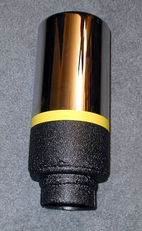

I used Monza resonator tips on my 3800. It dropped the noise level down significantly while at idle (750 - 1500 rpm's). At anything above 2000 rpm's, they do nothing to quiet it.
I have a catalytic converter, but no muffler. The system is made of 2.5 inch pipes. The exhaust system is heat shield wrapped from heads to tips. (tips get really hot...)
The tips are really cheap too. I got them for $10.00 each, and have had them on the car since 2002. They are all chrome and exhaust black color now.
But, you get what you pay for.
(edited to add picture)
