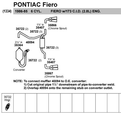

I believe the Indy exhaust is the same as the V6 exhaust on later years. Most exhaust websites only list a 4-cylinder and V6 exhaust - nothing separate for the Indy 4-cylinder.
This is from Walker's website www.walkerexhaust.com

Thanks for the suggestion. I received a similar response from the Fiero Store. They say the 6 cylinder exhaust from the cat back is the same exhaust system uesd on the Indy car in '84.
