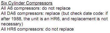

Using a mirror and a flashlight I was able to get these numbers off my compressor ( 87 GT)
Model : 1131468
Code : 081961
I have searched the net and can't find out if this is a DA-6 or a HR-6 compressor , I did find a list that had 1131469 listed for the Fiero but did not specify what type it was.
Anyone know where I can find out what compressor I have?

The HR-6 is the correct compressor for any V6 Fiero, as well as some of the 4 cylinder models. The HR-6 was intended to supersede the DA-6 in virtually all applications, due to its higher reliability. The 'R' in HR-6 stands for 'Revised' (i.e. HR-6 => Harrison, Revised, 6-cylinder design).

GM compressor #1131468 crosses to ACDelco #15-20240 which was used in 1985 Buicks and Olds with 3.8 engines, according to ACDelco. The clutch coil terminals are at 10 O’clock rather than at 2 O’clock (Fiero). So either the compressor was previously changed out or the ACDelco data is bad. Either way, it’s not a HR6 so it should be replaced when changing to R134a.
The code number (081961) means it was made on 08/19/86 (first shift) which is odd if it was for an 85 application. It would make sense for a 1987 model.

Thanks spark1 , thats the info I was looking for, I was searching and found a 1131469 was for the Fiero, (if i remember correctly)
Laying under the car with a flashlight and mirror reading backwards numbers, I bet that 468 is more than likely 469, ( close vision goes to hell after ya hit 40 )
So the date code is for 86, so its a DA-6 , I'll just get a rebuilt and be done with it.
