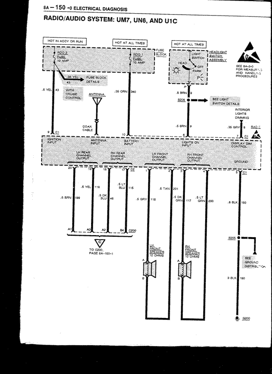

was wondering if anyone out there has a wiring diagram from a 93 sunbird im trying to replace the stock fiero with the small face radio front that has a amp and cd deck in different locations so i can put the cd player in the top of the center consol over the ecm and have spare space to put something else in the dash besides a huge friggin radio ok the radio is out a a 93 sunbird the face plate is model 16075872 and the amp/equilizer is model 16141203 hope yall can help me out thanx skoon

How's this? I have the schematics too, if you need them. -Jason

that is exactly what i was looking for and if you have them schematics i could use them 2 thank you thats awesome skoon

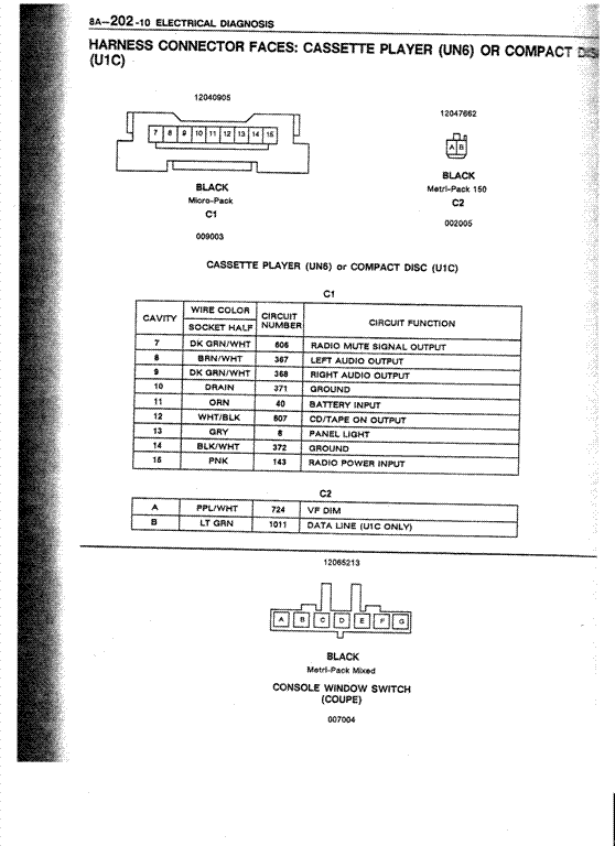

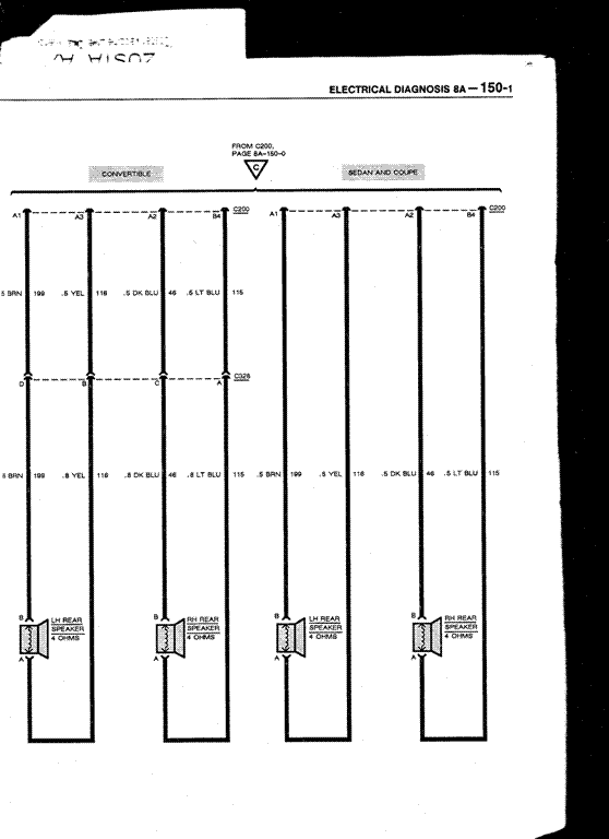

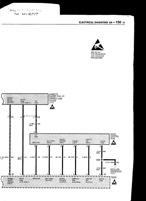

This better? -Jason
