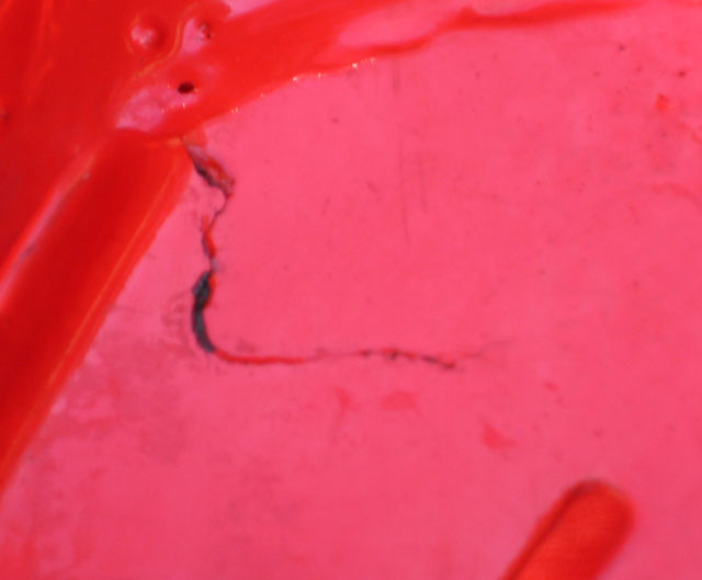

... and solid mounts.
Not exactly what I wanted to find.

What part is that exactly?

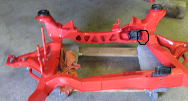

a nice weld should fix that ..is that the front mount on a sbc or the cradle frame?

You guys are quick. Here is the general area ...
I am thinking weld + gusset.

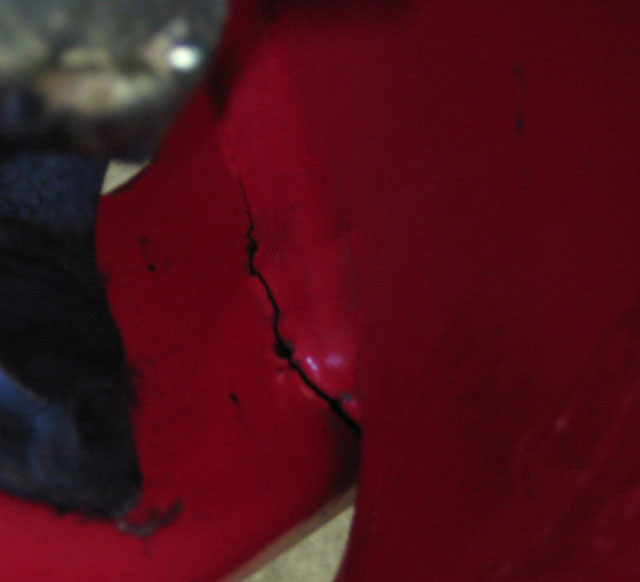

What I can't figure out is why these pictures I just posted are so crappy.
Everything as usual, PIP, 640 x ... , except different camera.

If it was solid mounted, it was essentially designed to crack.

Yup add some gusset plates in there and then it will be way stronger. I'd switch to poly though to give it a little movement to reduce the streses on the cradle. HP lost from letting it move a bit should be minimal.

I had immediate cracks in front mount before going solid. Last time I dropped the cradle all was fine but I definitely haven't abuse it as much as you (no track drag racing). Mine is an 88. Some reinforcing here and there should do the trick.

My 88 cradle cracked in about the same place on my 88 twice... (it was poly mounted and the isuzu/spec stage 3 lived, but not the cradle...). After the 2nd crack, I swore off stock cradle crossmembers. I replace them all with 2x3x1/8" steel tube and solid mounts and have been crack free ever since.
Here is another cradle I built this year (4.3 swap):

It looks like those cracks were there before it was painted maybe?
I agree. You can see that the crack in the first picture Tina posted had probably been stop-drilled at least once previously.
Powder Coated ... wasn't there before.
I sandblasted that cradle myself before it went to the shop to be powder coated.

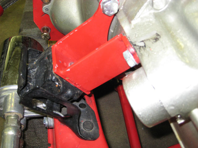

Tina,
These transmission mounts sure look like the stock rubber ones to me.
Are you running Archies solid front engine mount and the stock transmission mounts?

Report this Post04-14-2008 07:56 PM Click Here to See the Profile for TinaSend a Private Message to TinaDirect Link to This Post
Originally posted by Jefrysuko:
Tina,
I know ... Thanks to the crappy picture posted, it is hard to tell what it is period.
Let's try this again ...
Thanks Cal, I'll check that out.
Cradle is not leaving for repairs for another day or two. Trying to come up with a game plan by then.

The only pics I can find are the ones where I had it on my V6, but here is what it looks like. I will see if I can find pics of the mount and bracket installed on my V8.
