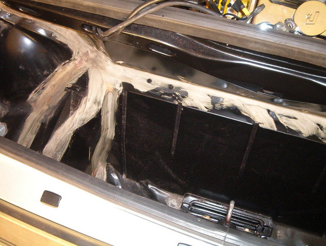

This is where I cut my trunk out. This way I could tuck up 2 Dynomax Raptor mufflers where the trunk used to be. I plan on fabricating a removable plate to cover the opening to aid in exhaust repair since my mufflers are stacked on top of each other. I don't have the completed pics yet, just the cutout. I'll take some pictures tomorrow if you want to see how the mufflers are located.

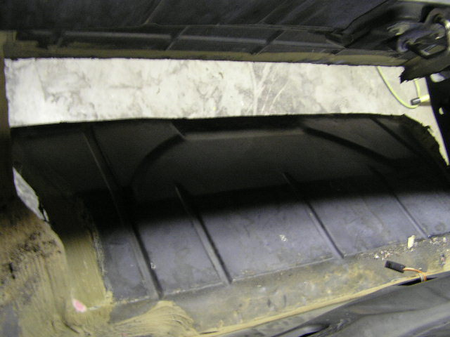

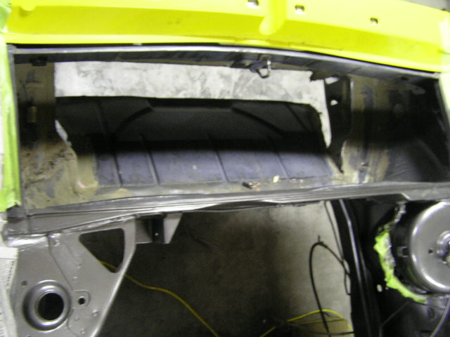

I kinda like when she flips me off. It's her way of showing affection. We are best friends and do almost everything together....including our annual New Year's eve drinking and driving contest (we split a few bottles of champange and play Forza2 until we can't drive straight or pass out).
Anyway, back on topic. I cut the trunk tonight and it came out nice. Tomorrow I will weld in the new floor and seal it up using Mercedes body sealant (damn this car will be spoiled).
