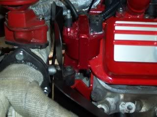

Most after market headers use larger dia pipes and a lot more of them than the simple stock headers, Even with ceramic caoting keep some of the shields. As for that coil, were's a tip, If you put it on standoffs of about and inch or two and turn it 160 degs, it will be a lot further away from the hot EGR and Y pipe. You'll need to make a few wires longer, but thats no big deal. See picture

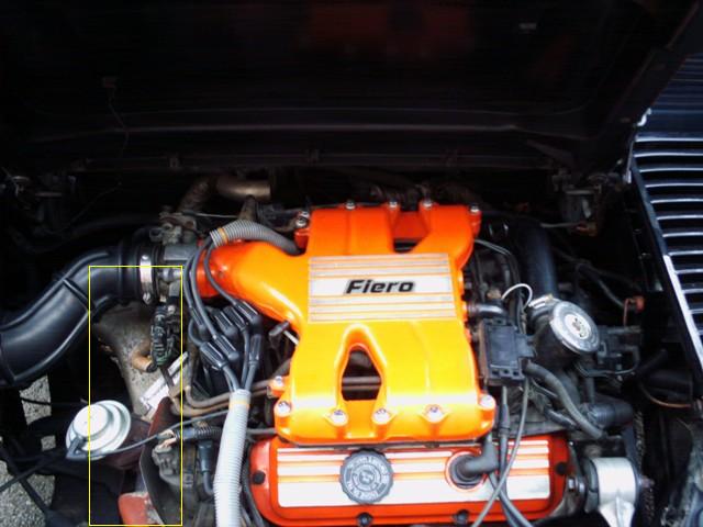

Originally posted by zmcdonal:
I don't remember seeing this on my 1988 GT. Do they also have this shielding on the y-pipe?
Robert 2
Posts: 2401
From: St Hubert Quebec Canada
Registered: Jan 2006
Report this Post04-01-2008 06:32 AM Click Here to See the Profile for Robert 2Send a Private Message to Robert 2Direct Link to This Post
Like that for a 88
Back of the engine , transmission side

The Y pipe shielding and EGR tubes were redesigned for '88. The Y pipe's shielding looks more like tin foil wrap as opposed to the solid metal bolt on shielding in the '85s-'87s. The head pipe in an '88 is longer than the '85-'87 so I'm guessing the '88 Y pipes are shorter than the earlier years.
