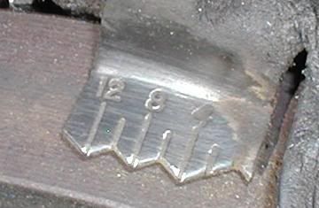

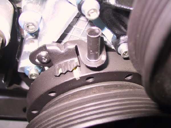

The easiest would be to remove the #1 spark plug then have someone turn the engine clockwise by hand while you place your finger over the spark plug hole. As #1 comes up on the compression stroke you will feel and hear air escaping by your finger. Now look at the harmonic balancer for the wide cut mark. There are 2 skinny and 1 wide cuts on the HB. (Each mark represents TDC for each cylinder in turn) Now carefully move the wide mark until it lines up with 0 on the timing scale. You should not have to move the HB very far in order to line up the wide mark. The outer ring on the HB has been known to shift causing major headaches. This is TDC for #1 cylinder.
Now look at the timing scale. It runs from left to right as 12 - 8 - 4 - 0 . The perfect mark is 10* Before Top Dead Center (BTDC).
The distributor rotor rotates clockwise. To advance the timing (go from 0 to 12 on the timing scale) move the dist counter-clockwise. To retard timing then go clockwise to move the timing mark from 12 to 0. Where is your wide mark at right now?
