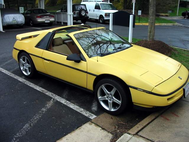

here is the link to the car I am considering buying.
https://www.fiero.nl/forum/Forum4/HTML/041513.html

Is that an original YELLOW, TTOP, Formula? IF it is a real CJB, yellow, formula then please don't convert it back to sunroof. That is like the holy grail of TTOPs. There is one driving around Virginia Beach that I have been trying to catch and buy for the last two years.

That car is too nice and worth more the way it is.
this is the only fiero I would not cut up.
I would find a sun roof car or hard top to chop.
also Archie has already said he would not chop a t top car.
it would be to costley to make the tops work in it.

You DON'T take a Yellow 88 Formula CJB and chop it. (even though it's not stock)
Yes, yes...It's a free country yada yada...Don't even go there, for less then that ($6500) just find another solid 88 GT with a blown motor and butcher it, put your choice of drive train and call it good.
Not sure if you wanted to chop and leave it as a notchback but IMO the lines look wrong on a NB chop top.
Please leave this car to someone that will appreciate it as -is
