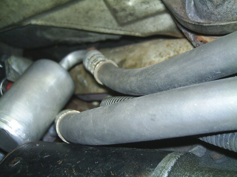

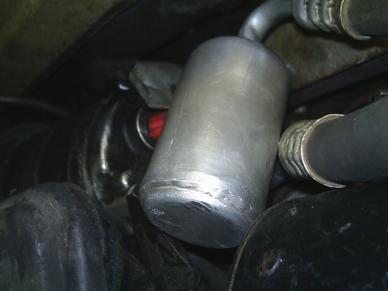

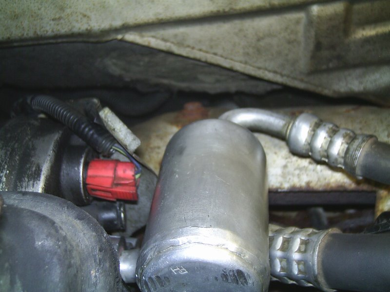

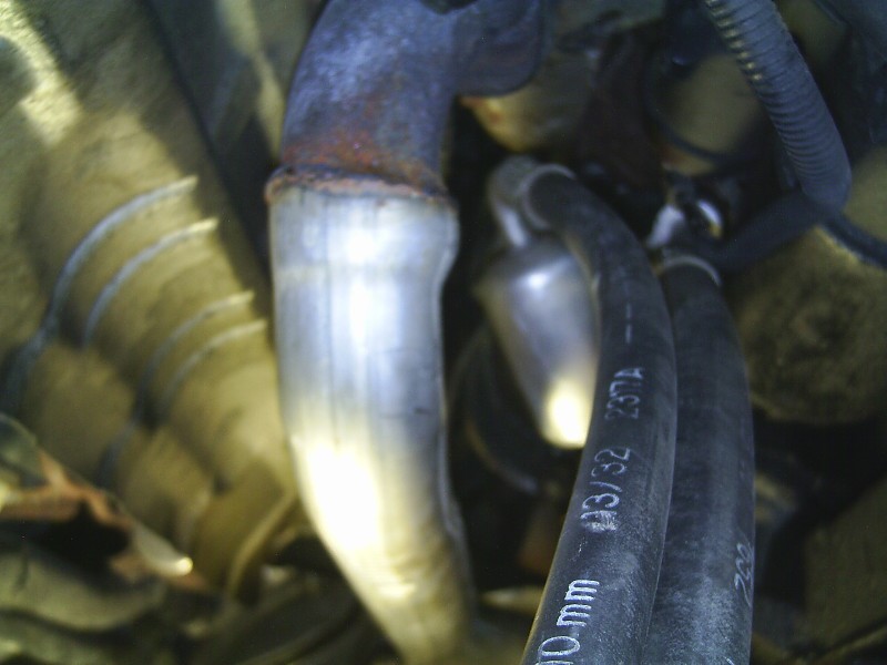

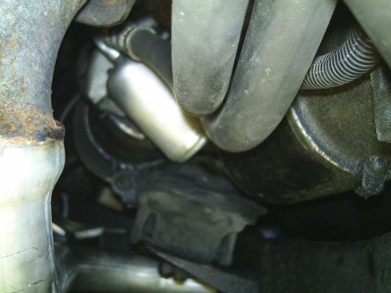

from loyde's site.
Nothing too special. If you find fiero lines that fit, remember that you need to get the "shims" that let you plug into the compressor.
If your compressor has just been hanging out on a floor somewhere, then there is a decent chance its got too much crud in the inside to be of any worth, but I guess thats only what i hear.
