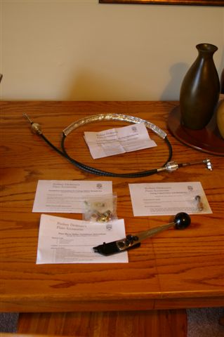

Ok, so I'm waiting on two things from Rodney Dickman: the Isuzu 5 spd shift lever rebuild kit and select arm rebuild kit. I want my shifting to firm up. My question is if anyone has had experience with these items and if anyone has tips on removing the shift arm and what needs to be done to get it loose (cotter pins, getting cables to stay in place after disconnecting them, cleaning, rust removal solutions to use, etc.).

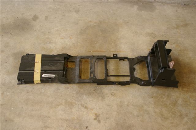

Also, my shift console is warped and the glue is completely gone. Does anyone have experience either repairing these consoles or using the shift console cap from the Fiero store? You know, like what type of clamps to use, glue type, method, etc.

I have done a couple of shift console repairs before and they turned out well. I used some small clam shell type clamps and super glue gel. I have a radio/climate control pillar I want to do that to this weekend also if I have time. Maybe I can do some pictures then as well. Do a search in the archives for Yellwostone. I think he did a great example of this a year or two back.

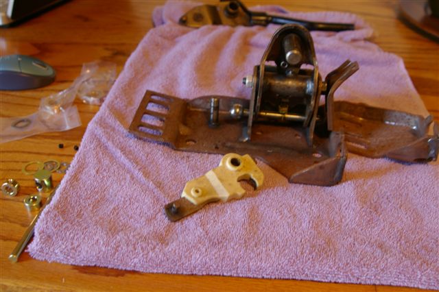

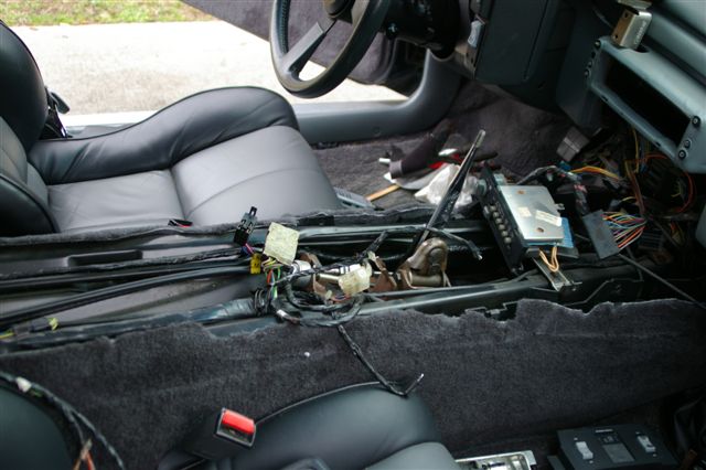

I did the Getrag shifter rebuild, the selector arm rebuild and selector cable replacement this weekend. As a reward to myself I added the Hurst Shifter as part of this task. The rebuild did not take as long as the disassembly did. There is a lot to take off to get to the shifter and you want to go slow because so many of the parts are pretty delicate like the console skeleton. Don't worry about the cables moving while you have it apart they don't and it wouldn't matter if they did.
My shifter wasn't too bad in the way of dirt or rust so I just cleaned it up some and put it back. If yours is pretty rusty or gooey from years of having stuff dumped in the console you may want to allow extra time to clean it up. Rodney's kits always come with pretty good directions so just work your way through them and you will be fine. The shifter rebuild is a little more complicated than most but still easy enough. Here is my goodie bag of Rodney kits.
This is the car when you finally get it out.
Here is the shifter before I started on the rebuild:
In this one the shift arm is removed:

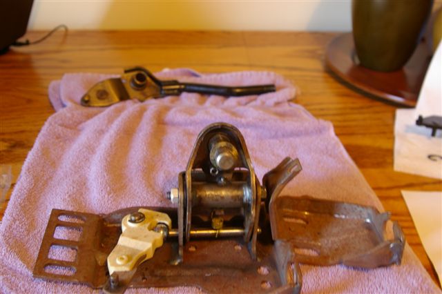

The next one shows the select arm removed.

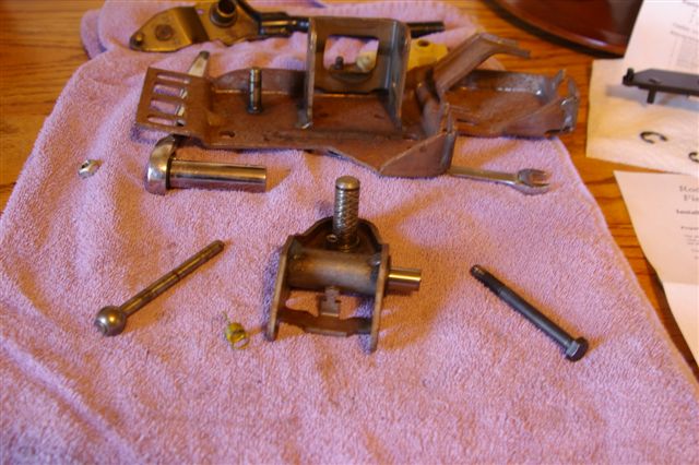

Here are all the pieces/parts after everything is taken off.

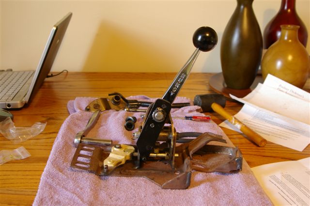

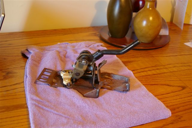

And finally my rebuilt shifter.
This is picture of the console skeleton. If you look at it hard parts break off. It is that delicate.
My selector cable definitely needed to be replaced. My shifting is so much easier now. Replacing the cable only took a few extra minutes with the console disassembled and It made me wish I had done the shifter cable too. It will be a pain to take all back apart again.
