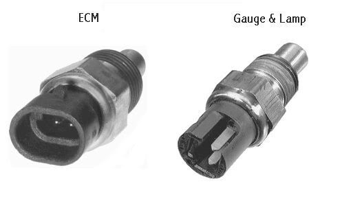

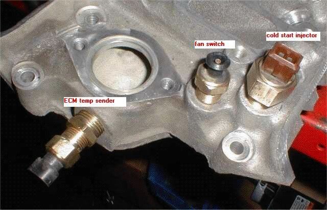

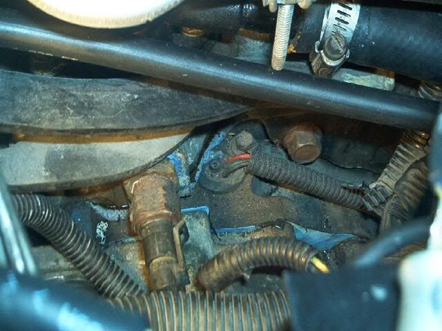

The code 15 for coolant temp sensor is the one for the ECM, not the gauge temp sensor or the fan switch (another temp sensor). We have all kinds of different sensors to go bad! The one you are looking for is located below the thermostat housing in the lower intake manifold. I'll post a pic. The test is to place an ohmmeter or multimeter set to ohms on the 2 little pins and read the resistance. You do this when the engine is cold and you know the exact outside air temp (place a thermometer on the engine overnight). You will probably need to remove it for this test as it's hard to see much less get the multimeter probes on those 2 little pins.
Here is the ECM coolant temp sensor on a lower intake manifold (plus the cold start temp sensor and fan switch (temp sensor):
This is installed in the car:

You remove the sensor for ease of access, it is not required though. Since you will lose a bit of coolant it would be better and faster to test it right on the car. You don't remove the lower intake. If you decide to remove the sensor, just drain enough coolant to get the level below the sensor. There is not too much coolant in that area. The bulk of the coolant would be in the block, tubes, and front radiator.

ok i think i figured out the promblem. but i still get the code once it has ran for a little while. but i think i know what it is. the plug for the ecm temp sensor was a bit corroded and it is also cracked. so i am pretty sure that is what the promblem is. (crossing fingers and toes and what ever other body parts). and yes i have unhooked the battery for 20min just to make sure. so with it being loose and crack it just is not getting the right conction. figure i would put that down so Hudini would be happy. jk but thanks you all.
