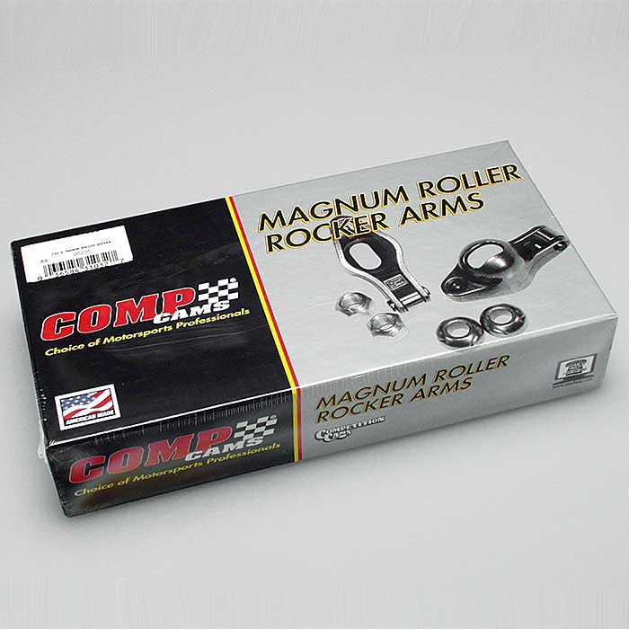

Here are my three options from the Fiero Store:
1. $159.95
COMPETITION CAMS 1.52:1 ROLLER TIP ROCKERS
Competition Cams Magnum roller rockers offer an accurate 1.52 rocker ratio. Stock stamped rocker ratios can vary from 1.46 to 1.50. With Magnum Rockers at 1.52 it effectively increases a standard .420 lift cam to .432 lift. With the increased lift and the friction reduction at the valve horsepower increases and rev's are quicker.
2. $169.95
COMPETITION CAMS 1.6:1 ROLLER TIP ROCKERS
Magnum Rockers at 1.60:1 will increase valve even further than the 1.52:1 ratio rocker for even more HP out of a stock or performance camshaft. The roller tip also reduces friction for easier rev's.
3. $329.95
CRANE GOLD ROLLER ROCKER SET
Stock stamped rocker ratios can vary from 1.46 to 1.50. These Crane Cams Gold series roller rockers are 1.60 ratio for increase valve lift. With the increased lift and the friction reduction from these full roller rockers, horsepower will increase and the engine will rev quicker. These rockers have a narrow body (not self-aligning) for valve cover clearance. The special 10mm x 1.50 bottom x 3/8" x 24 top rocker arm studs are included so no machining is required to the heads.
Also, I am using the Crane H-272-2 Camshaft.

I would personally go with the second set. They are 1.6 as well as the gold ones, so theoretically they should offer the same performance. The gold ones may be somewhat stronger, and even if they do offer better performance being a true roller setup, its not almost-double-the-money better. Of course it all comes down to how you want to use the engine and what your personal preference is.

I have a set of 1.6 roller tips. They work very well and lower the pitch of the exhaust. The 1.6 adds lift and it kind of depends how much lift your cam has. If you go too high you can get binding in the springs. Crane cams has some good info on their website.

Since you have a Crane 272, Not only do you have to recheck valve springs for binding, But now piston to valve clearence could be an issue. Your max lift goes from .480 to .513 if you use a 1.6 ratio rocker.
Unless you plan on spending a lot of time at WOT or racing every weekend, The full-roller rockers will not have much of an effect over the roller tipped ones.
I would go with the Comp Cams 1.52 and their heavy duty pushrods. More accurate lift with stronger and better oiling pushrods.

Another vote for the Comp roller tip 1.52s.
I'm running the same thing in my 3.4 w/ the 272 cam.
As mentioned, if you go with the 1.6s, check your clearances.
The 1.52s will also be easier on your cam and lifters. Never a bad thing with the 272, from what I've heard.

A couple things:
1) The possibility of mechanical interference using the Crane Cams H272 with 1.6:1 rockers is very high. With this setup, the lift at the valves will exceed 0.500" on the exhaust side. That will require special springs, and possibly even some head work. As mentioned above, in addition to valve spring bind, there also exists a very real possibility for valve-to-piston interference. Only a fool would stick these parts into an engine and just cross his fingers.
2) Keep in mind that the 1.52:1 ratio rockers will still provide a slight improvement in valve lift (and a more accurate ratio) compared to the stock stamped rockers. But at least in this case, the increase in lift won't be enough to trash the engine.

Also, I am going to start with roller tipped 1.52 rockers and do a baseline dyno, and then swap them out for full roller rockers, at 1.52 ratio later for another dyno. Should be interesting.
