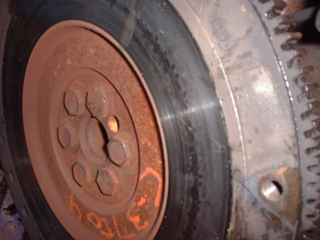

The easiest and safest thing to do is go to a clutch builder and have them integrate the clutch parts properly so that it all goes back together in stock form. I was made aware of this option back in 96 by a Clutch rebuilder who offered to do just that and ultimately produce a finished product stronger than the stock S10 unit since spring pressure could also be increased. The clamping pressure is about the same, however the larger diameter provides more holding capacity in the form of twisting leverage with the disc lining a little further away from center.
You could also have had the outer perimeter of the flywheel machined down some instead of the entire flywheel to allow for a little more clamping pressure with the pressure plate mount pads being a little lower than the clutch disc friction surface on the flywheel. That method would insure higher than usual clamping pressure as the clutch disc wears and gets thinner.
As for my comment about the spring pressure in the S10 pressure plate being about the same, that came from an inquiry with SPEC years ago when I was looking to increase holding capacity by using S10 parts.
Here is my stepped flywheel after the engine was removed for my swap. I discovered something important about dual friction semi metalic discs, they are hard on flywheels, you can't see it in this picture but the friction surface was worn down to about the same amount the perimeter of the flywheel was machined.
