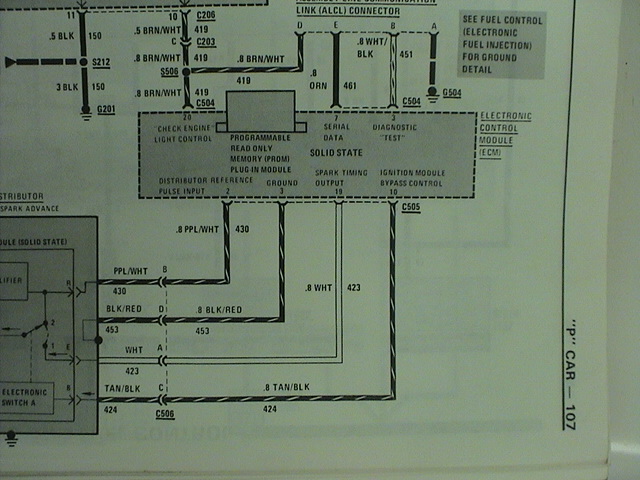

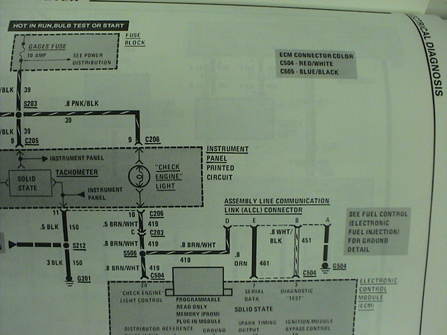

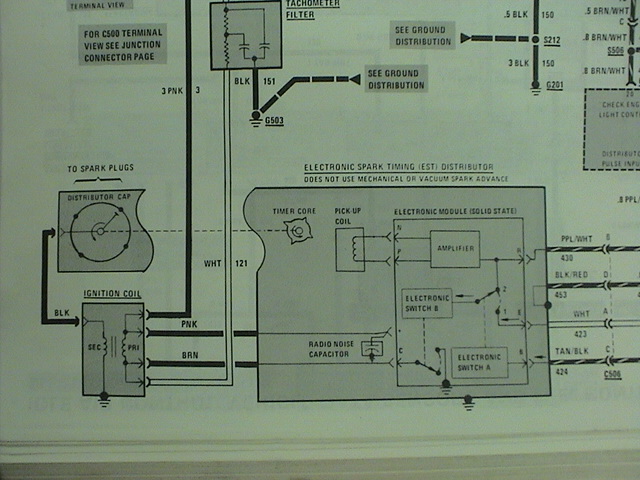

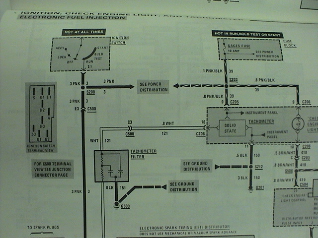

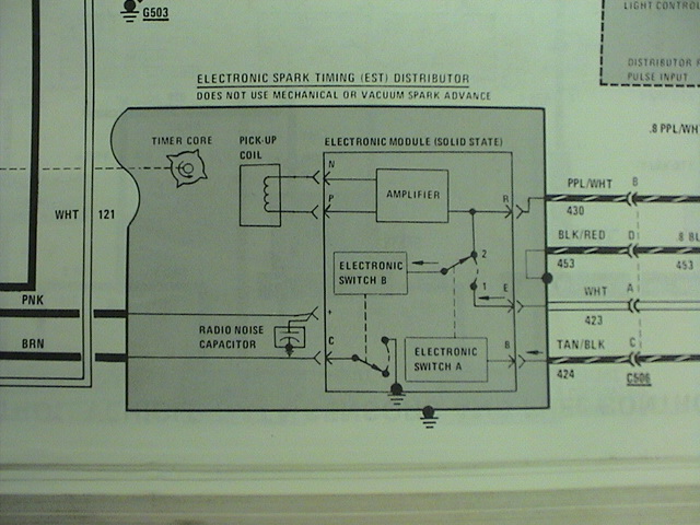

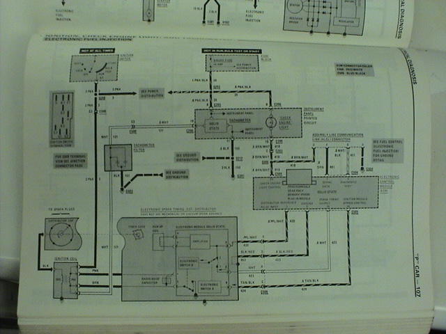

this is just the module in the distributor.
this a factory 84 service book and i didn't see any resistor in the circuit
i wonder if you are talking about the tach filter?
