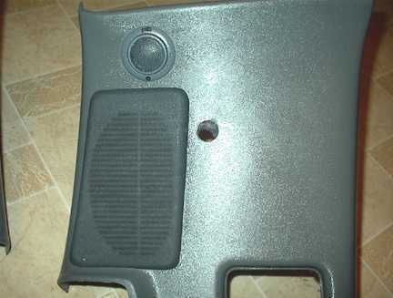

The standard coaxial 4X6 ovals will fit with no problem. Some of the higher end, higher power ones have deep magnets and you can add a spacer plate if these are the speakers you want to use. Depending on how much room you need, The sail panel might bulge a little but should look fine. As for the 4X6 plates that use a 3.5" woofer and a seperate tweeter, They will fit but you do need to do a little cutting/bending of the metal for the magnet because it is offset from the center and the hole in the metal is oval.
A third option is to make a spacer plate that is the same thickness as the stock one then install a 4" round speaker with a seperate tweeter like I did:
Other pics here:
http://www.polkaudio.com/ca...talls/view.php?id=13

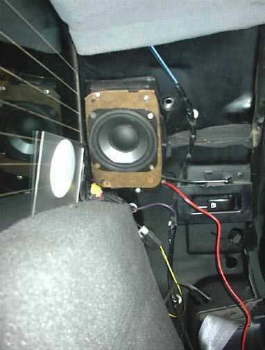

Scosche 4x6 plates PN SA463. You can mount whatever 3.5" midrange/tweeter component set you can fit in the pillar.
http://www.audiooutfitter.c.../scosche/p77088.html

Plates will work fine, but you have to be aware of the magnet sizes - large magnets will cause fitment problems. This also applies to co-axial 4x6 speakers. I have Infinity plates and they work fine. Others say Infinity's don't work. Infinity and other companies usually make more than one model of speaker and sometimes their magnet sizes will be quite different.
Compare the Infinity Reference 6422.CPF magnet
to the Infinity Kappa 4627.CPF magnet (Neodymium motor structure with integrated heatsink)
Just to put in my two cents, since a lot of people seem to be wondering if infinity fits, I have the exact same speakers as the first image here in my posts. Fit very nicely in my opinion

I have Polk Momo 4x10s in the dash and Momo 4x6 plates in the back. The 4x6 plates were a pain and had to do a little trimming and hammering but the sound is worth it. Im driving them with just a Alpine IDA-x001 and it sounds awesome. My son asked if I had put a sub it.
Bazooka- Thanks for that info. I just do not want to modify anything. With these you just bolt up, plug in, and put the b-pillar cover back on?
