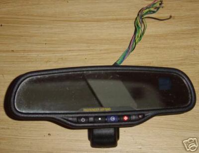

I won "IT" on E bay this evening, a self dimming,with temperature and a compass display out of a 2006 Yukon for $22.48. I'll get it installed and hooked up and pretty quickly after it gets here.
I also have an auto dimming mirror with out the compass or temperature display if any body is interested, I have 10.00 in it. I bought it before I learned about these fancy ones.

that gets tied into the bcm for its functions...ive got one from an older buick that gets its info from sensors actually on the mirror and temp sensor on the grill.
the bcm controlls the function of the compass by selecting what zone and part of the world youre in. the auto dim recives its info from the light cell on front and pwer from the bcm. the temp is controlled throught the bcm and auto air controlls.
put that one back on ebay, make some cash and get one from an older car!

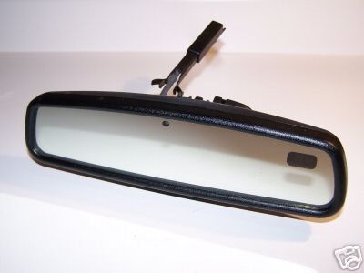

This is the one with the Red or "Pontiac Red" display:
