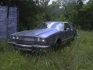

Ok I just bought the parts car for my th325-4L
http://i233.photobucket.com.../root_command/85.jpg

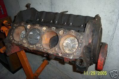

and the engine an 84 chevy 350 (will of course need to be rebuilt)
http://i233.photobucket.com...t_command/engine.jpg

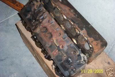

and late eightys early ninetys vortec heads
http://i233.photobucket.com...ot_command/heads.jpg

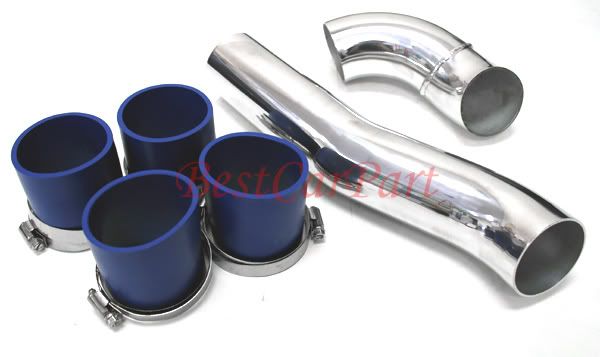

What do you guys think of this for my 350 swap?
one qestion can you run the carb before the intercooler?
do you have to worry about knock sensor or computer controlled crap on 80 trans am turbos?

I just thought as far as pressurizing a carb couldnt someone weld some aluminum pipe aroud the top of the carb and hook EFI intake pipe to that? I think that just might work
ducattiman
Posts: 674
From: TheNetherlands
Report this Post09-14-2007 01:51 PM Click Here to See the Profile for ducattimanSend a Private Message to ducattimanDirect Link to This Post
WTF IS EFI INTAKE PIPE????
and why not just seal the whole carb in a box and then alot of problems r solved,,,,,,look up a company called Gale Banks,they were the MASTERS of turbo'ng carbs,,,wtf wait a min...........

Ace McCloud
Posts: 167
From: Marble Hill, Missouri, United States
Registered: Jul 2007
Report this Post09-15-2007 09:28 AM Click Here to See the Profile for Ace McCloudSend a Private Message to Ace McCloudDirect Link to This Post
EFI intake pipe is just what I called it, it is this stuff, most EFI intake systems are made out of it. Just simple aluminum pipe I assume.
http://i233.photobucket.com...mmand/SR_BL93RX7.jpg
Sorry about the photo bucket I am in Ubuntu (Linux) at the moment and PIP dosent work.
The things you run into when pressurizing a carb is leakage & lack of fuel pressure. If you seal the carb, you can run a pressure line to a mechanical fuel pump (inlet side) to increase the pressure so that the turbo does not out power the fuel pump. In other words, if the pump is pushing 5 psi, once the turbo gets to that boost it will overpower the fuel pump & stop the flow of gas.
Building a box around the entire carb *is* the best way to overcome the "sealing the carb" problem. Also, a Predator is a good carb to pressurize on top as it has less places to worry about sealing.
