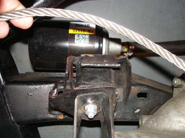

$Rich$
Posts: 14575
From: Sioux Falls SD
Feedback score:    (20)
Total ratings: 398
Report this Post05-31-2007 08:16 AM Click Here to See the Profile for $Rich$Send a Private Message to $Rich$Direct Link to This Post
heres a few pics of mine from my V8 prettymuch the rubber was repplaced with steel,
worked great, i was running a pretty stout 355 SBC, and the ride was nice, not obnoxious at all

chrishahn87
Posts: 1584
From: East Berlin, Pa - USA
Registered: Dec 2004
Feedback score:    (22)
Report this Post06-02-2007 08:33 AM Click Here to See the Profile for chrishahn87Send a Private Message to chrishahn87Direct Link to This Post
+ to you $Rich$ for showing pictures!
+ to the others who have helped.
Thank you!

I use stock rubber mounts with a 3/8" hole drilled through the steel top and bottom plates and the rubber inbetween. I have the bolt just snugged down to the steel plates with a nylon locknut. That way I have the benefit of (some) vibration absorption with the ability to absorb heavier shock loads. This may not be the "right" way to do it either, but it has kept the tranny in the right place on my race car after I broke a couple stock mounts.
