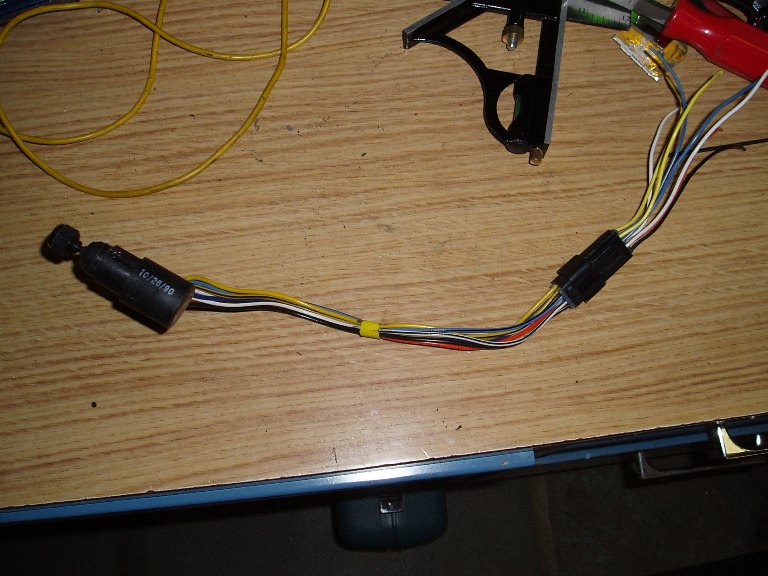

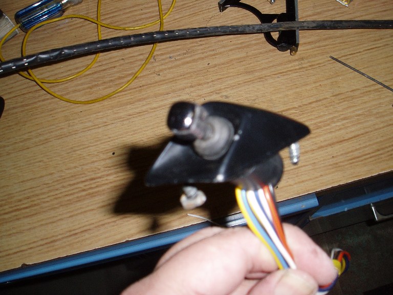

I wanted to put power mirrors on my 86 GT for awhile now. I found a set of mirrors on EBay complete with harness and switch. The problem is I made a custom center console with cup holder and does not really have room for the switch and I really do not like the factory switch. Was at the u-pullit yard and found a switch from a 1985 Cadillac Deville. It goes right into the factory manual mirror control and is held in place with a set screw just like the factory did it. It appears this switch was used on several GM cars of this vintage.
Here are some pictures of all this.

I have not put everything together yet as I am replaceing the dew wipes and door skin. Probably will not get mutch done until next weekend.
It is pretty simple if you already have manual mirrors. The control for the manual mirrors is held into the housing with a set screw on the window side. Remove the screw and the control wires slide out the back. Push the new electrical control in from the back aligning the flat on the switch with the notch in the housing and tighten the set screw.
The wiring colors are a little different. I will post a diagram when I install it next weekend. Still pretty straight foreward though.

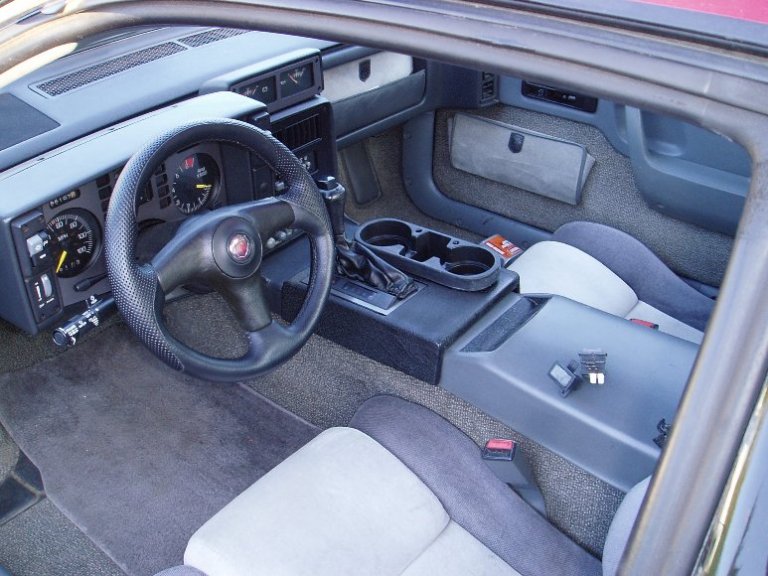

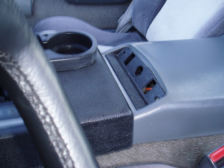

Not to get to far off topic but here is a picture of the center console I made. The back of the cup holder is not seated as I am working on the window switch relocation.
Window switches go here

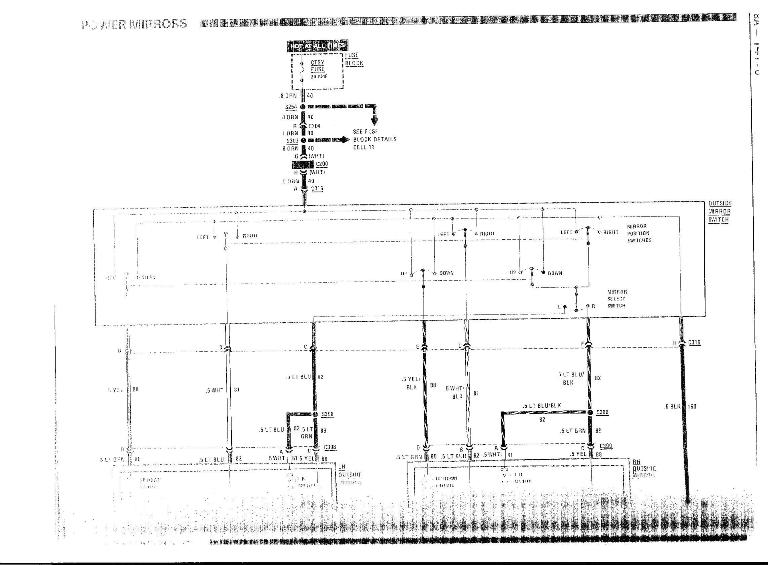

Here is the schematic I used from the 85 Cadillac Deville.
Sorry for the poor quality as I had to scan it from the service manual. If you save it and blow it up it is not too bad.
