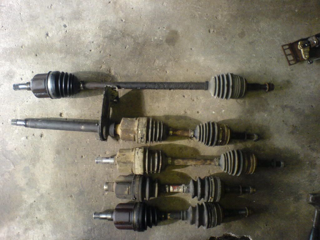

Report this Post05-01-2008 06:53 PM Click Here to See the Profile for ErikSend a Private Message to ErikDirect Link to This Post
Erik
5628 posts
Member since Jul 2002
here are the different Fiero axle lengths ..the one plugged into the intermediate shaft is the shorter automatic Fiero axle
the next one below is the longer Fiero auto axle
the next one below that is the sunbird axle
and the last one is the shorter Fiero manual axle
as you can see the longer Fiero auto axle is the only choice to use and it will have to be shortened
anybody done this??
