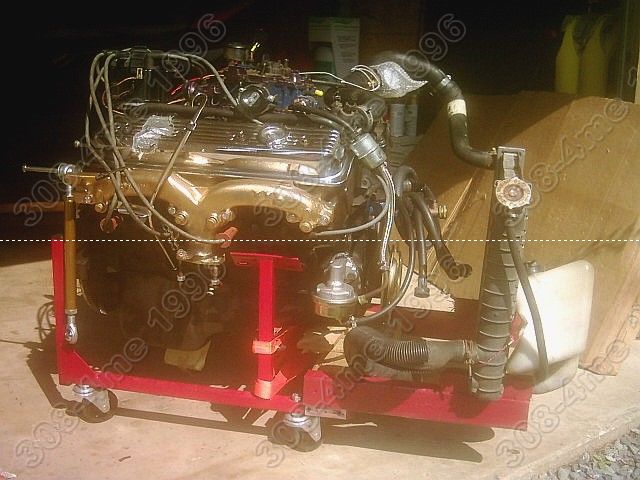

1963 to 1966 Corvettes have 2.5 outlets. These are the ones I've used on my 3 swaps. Other years of Corvette had 2.5" outlets and some years used smaller 2" and 2-14" outlets. I'm not sure of the other years but I do know the 63-66's work well.
Also, some older late 60's early 70's trucks used 2.5" outlet Rams Horns as well. I really love the re-pro ones being made now. I recently saw a set made out of cast stainless that looked great. Lot's of options out there now.
