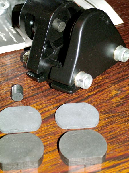

About the rattling of the wilwoods, I havent tried them yet but these 3 pieces will be only held in place by the rotor...

I'm glad someone has a closeup of one of these. I know wilwood makes good stuff but that looks like junk. Something you would but on a pallet jack or something. Yeah, I won't be doing that. I've got a new plan cooked up to use C4 calipers in the rear and customize them. Hopefully it works out.

I think that the wildwood brake would hold a fiero on a slope if it was parked in gear. I've got kind of a steep driveway and if I park my 2m4 in reverse, it will slowly creep down the driveway. I don't think it would take much to stop this. I just wonder if there might be a way to quiet the rattle when driving at highway speeds.

I basically need these Wilwoods to pass ebrake inspection...that is checked by applying the ebrake with the wheels off the ground, and the inspector tries to turn the wheels and they should stay locked...
I think I will glue the pads to the backplates and put a thin layer of flexible sealant around the edges, hope it will keep them from rattling and still being able to move out...
For vented discs you will need more spacers and longer bolts, now when I ordered them from Summit extra spacers should be available but I couldnt order them
You'll need even longer bolts to mount them to a bracket. If someone needs specific close-ups let me know, theyre still on the table
