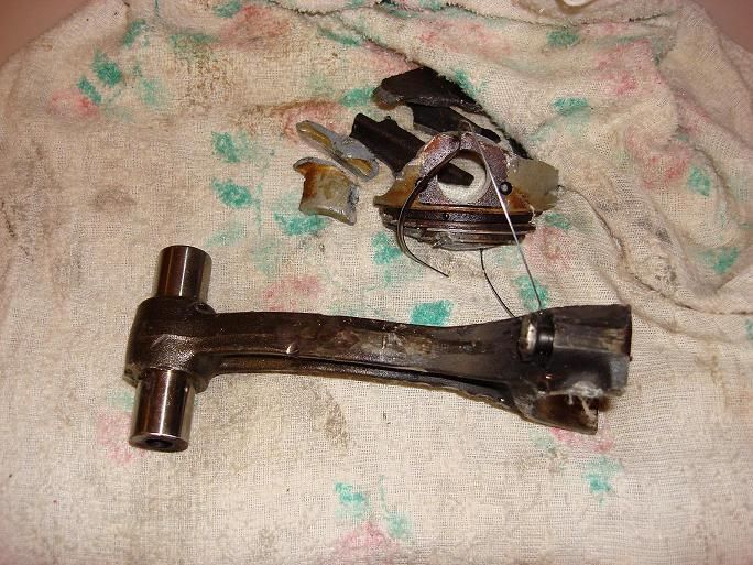

you mean like this?
this happened to my other car last month. i haven't worked in awhile. i guess it's time to get a job and buy something new.
